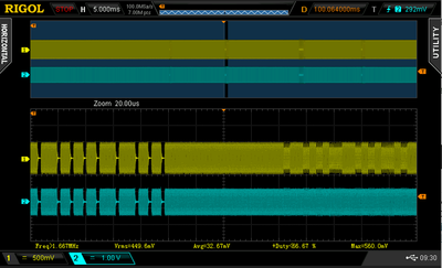

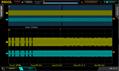

We have now made some tests, with spy coils.
Signal from spy coils are sampled, and distance from NFC coil to NFC tag is slowly changed, until communication stops.
There is not much difference to see: The signal at the coil is maybe 15-20% higher amplitude.
From the screenshots, it looks like the tag responds to the TX signal from the ST25, but the communication is not accepted/failed.
Can you conclude anything from these screenshots?
The first one is with OK communication, the second one fails:
Yellow = Spy coil close to tag
Blue = Spy coil close to coil
Hello Kaare,
from the scope shots i cannot see anything being obviously wrong.
The amplitude on the tag spy coil is reducing a bit, but the tag is still responding => sufficient power.
Next step would be to generate some digital traces of the SPI using a saleae or digiview digital analyzer.
There we could exactly see what the problem would be.
BR Travis

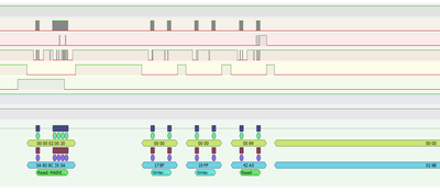

Hi Travis
We have made SPI traces in both situations. At first glance, there are major differences.
Can you read .sr / .pvs file formats?
We use PulseView, which is free to use, and works great.
Or would you like me to write down the commands/SPI communication in plain text?
Screenshot from PulseView:

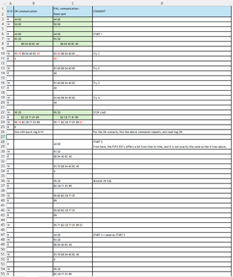

Hi again
I have tried to zoom in on the SPI traces, but there is A LOT of communication going on...
To simplify, I have tried to focus on the SPI FIFO commands, and compare the sequence when communication is OK, to the situation where we are in the blind spot, and detecting tag fails:
See the screenshot below (I hope you can read it).
NOTE: I have not looked deep int the user manual, to check all commands.
For now, I have just managed to find some differences in the SPI communication.
Some comments on my observations:
- The first few FIFO commands looks the same (green)
- Then, of some reason, the the W+R in line 10+11 is not exactly the same
- After this, the OK scenario ends with som commands, and then repeats later. But the FAIL scenario tries 4 times with no success.
- After 4 tries, the FAIL scenario seems to start again, but it does not continue the 4 tries as earlier.
I will try to investigate more, but there is so many commands and possible analog tuning which would take me forever to fully understand. So I hope you Experts can help  :)
