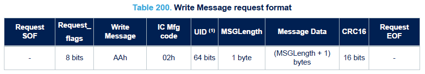

I am performing FTM Demo (Firmware Update) on ST25PC-NFC using ST's STEVAL Reader Board. I have disabled the Fast commands from settings, so FTM is using writeMsg command. Below, I have added a snippet of one of the packets being sent.

The packet aligns well with the Write Message request format from the datasheet except for the MsgLength and Message Data part.
  • Request Flag: 22
  • Write Message Command Code: AA
  • IC Mfg Code: 02
  • UID: 329411AE665102E0
  • Msg Length: FF
  • Message Data: 08180C.......E1818181818
  • CRC:
My understanding is that MsgLength refers to the length of the Message Data and not the entire packet. Based on that understanding, MsgLength value should be 238 bytes and Message Data length should be 239 bytes (MsgLength + 1 byte). However, in the packet above, the MsgLength is defined as FF (255 bytes)

From the packet breakdown, the MsgLength is 2F (47 bytes), but if we manually calculate the Message Data length, its 49 bytes, which is not as per the format formula MsgLength + 1byte (48 bytes).
Why is different packets size sent for different readers and how exactly is Message Data size calculated?

regarding your first question, my reading is that the MsgLength value of 0xFF (255 +1) size matches the 256 bytes of data that follow. If we take your frame:
2026-03-24 10:04:20.785 writeMsg >> 22AA02329411AE665102E0FF08180C180C180C7FF87FF00000000000000000000000000000000003EC0FFC1C1C180C300C30003000300030003000180C1C1C0FF803F0000000000000000000000000000000007FC07FF018381818180C180C180C180C180C180C181818387FF07FE0000000000000000000000000000000007FF87FF818181818199819801F801F8019801998181818187FF87FF8000000000000000000000000000000003FFC3FFC0C0C0C0C0CCC0CC00FC00FC00CC00CC00C000C003FC03FC00000000000000000000000000000000003EC0FFC1C1C180C300C3000300030FE30FE300C380C1C1C0FFC03F0000000000000000000000000000000007E7E7E7E1818181818
2026-03-24 10:04:20.893 writeMsg << 0000
Data block [08180C...181818] is indeed 256-byte long.
For the second example, the MsgLength also matches the length of data that follows: a value of 0x2F means data to follow contains 47+1 = 48 bytes of data. Which is also the case in your example:
2026-03-24 10:12:53.258 writeMsg >> 22AA02329411AE665102E02F08206D617920626520627573792E0A506C65617365206D6F766520746865207265616465722E2E2E0A4F72207265636F
Data block [08206D...65636F] contains 48 bytes.
The confusion may come from counting the MsgLength byte in the data length. It shouldn't be included as MsgLength strictly quantifies the bytes that follow.
