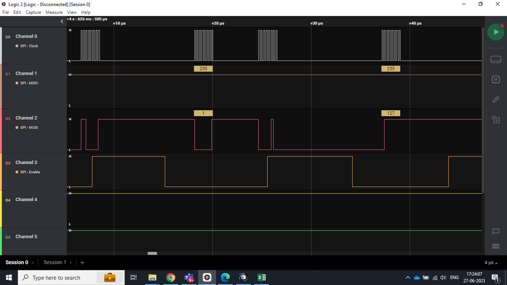

Code comes till st25r3916CheckChipID function but then directly returns out of the function.Screenshot (213).png
Brian TIDAL
if D1 is the MISO signal, then it seems to be always up...
if D3 is CS signal, then it seems to return high too early...
Make sure to enlarge the column with the signal name so that we can easily find each signal.
Check your SPI configuration and connection. Make sure also to power the device on the nucleo board. In Salae, make sure to configure the SPI decoder with CPOL=0 and CPHA=1 (this should as well be the SPI configuration inside your MCU).
Rgds
BT

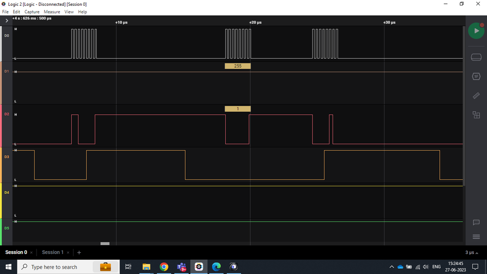

As mentioned the configuration is made in SPI and in logic analyzer, this is the picture with signal names
I have defined ST25R3916B in platform.h
The st25r3916CheckChipID() function returns false value . it enters the st25r3916CheckChipID() function but inside it comes till here,
#elif defined(ST25R3916B)
if( ( (ID & ST25R3916_REG_IC_IDENTITY_ic_type_mask) != ST25R3916_REG_IC_IDENTITY_ic_type_st25r3916B ) ||
( (ID & ST25R3916_REG_IC_IDENTITY_ic_rev_mask) < 1U ))
return false;
It checks first if condition only and comes out of a function.
the driving of CS is obviously incorrect as already hinted by Brian. The chip gets deselected in the middle of a byte. Likely the SPI driver of Renesas returns before having completely finished the transmission. Then the software generated CS going to deselect is too early.
Just record the checkChipID(), it should have something like 0x7f on MOSI followed by the device ID on MISO.
Regards, Ulysses
