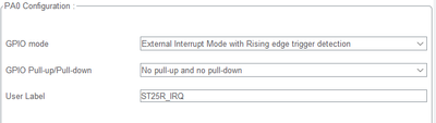

Is the Interrupt pin of the ST25R100 (A0 on the X-NUCLEO-NFC09A1 arduino connector) properly configured on PA0 as GPIO_EXTI0:
Make sure to have the following PA0 configuration:
And make sure to enable EXTI Line 0 interrupt

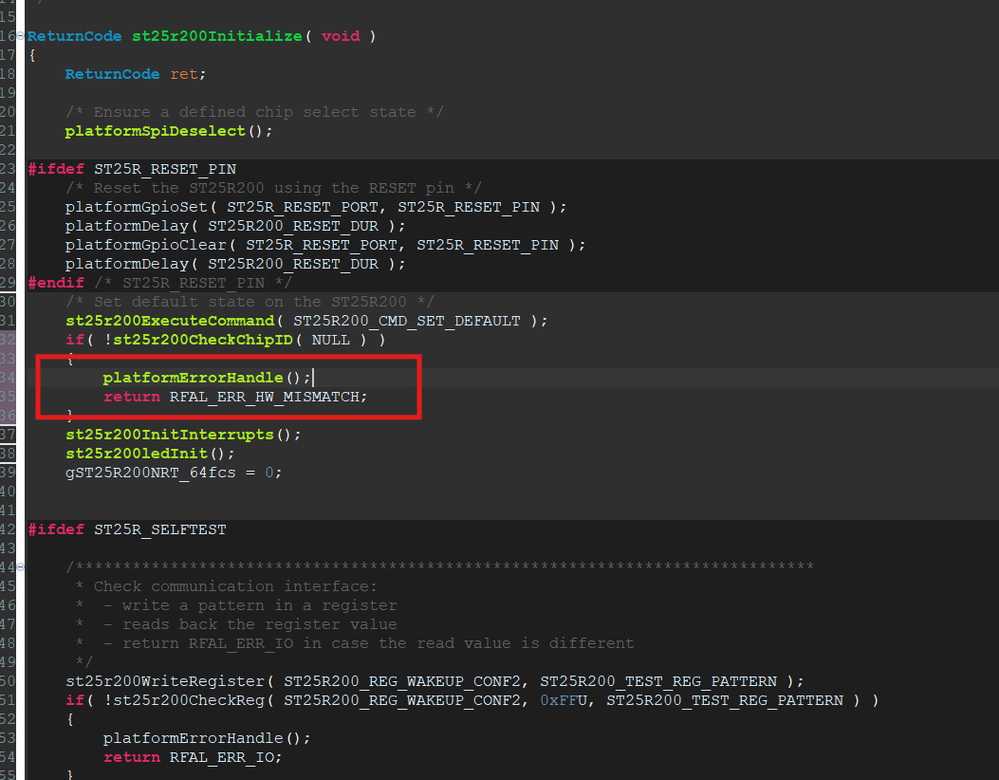

To further debug, you can enable ST25R_SELFTEST compilation switch, set a break point in st25r200Initialize and run this function step by step and send me information about where the failure is. Also feel free to share your ioc file.

Interrupt pin of the ST25R100 is properly configured as above.
but during debug time, code is stuck in  "platformErrorHandle();" function. I have attached a snippet bellow:

When reading the identity register 3Fh, the returned value has a wrong value. This causes st25r200CheckChipID() to return an error.

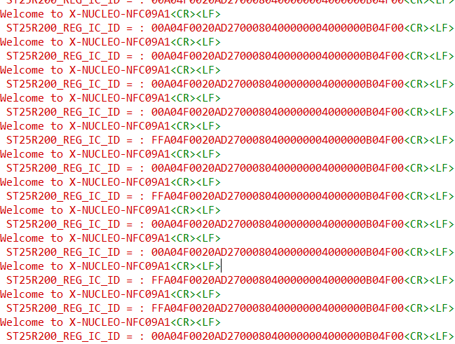

I have traced my complete hardware. all the pins are connected & working properly. could you please let me know what will be the correct chip ID. I have attached here a snippet of chip IDs:Screenshot 2024-09-03 165429.png

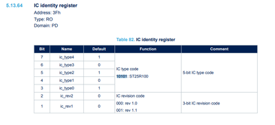

good to see that the BSS issue seems to be solved on your side. The snippet of the Chip ID is strange. Register 0x3F (IC Identity) is a single byte register. I am not sure to understand the printing (it seems to be an erroneous printf parameter). IC Identity binary value is 10101xxx. See §5.13.64 in ST25R100 Datasheet.

Hi Brian,
All these IC Identity values are in ASCII values. I have put length 20 byte length so that it is showing a strange value.
For single byte, IC Identity value is the first 2 digit of ST25R200_REG_IC_ID in the snippet.

I guess the SPI communication is still not operational as having 00h of FFh for the IC register is not correct: can you connect a logic analyzer on SPI(CLK, MISO, MOSI and CS) + IRQ_ST25R100 and send me the trace?
