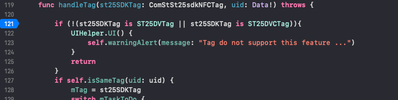

In specific, I get problem with following code in from "ST25DVMailboxManagementViewController"
The following condition fails in my code, but succeeds in iOS NFCTap App.
if (!(st25SDKTag is ST25DVTag || st25SDKTag is ST25DVCTag)){}
Did anyone face something similar?
Any leads will be greatly appreciated.

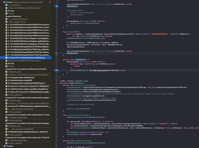

Hello Vincent,
 Thanks to you, now my product id seems to be working.
But the problem continues as everytime I try to access the mailbox status, it simple fails without an exception.
Any idea why this can be the case.
Attached a screen capture for your reference.
hi Aly,
Ok good news : from now, tag is instantiated well.
Regarding your traces, I see that even a single read command fails.
How do you call iso15693 commands into your code ? What is the value of flag parameter ?
Could you send me a more detailed log on command sent ?
Thx and br,

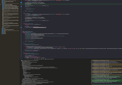

Hey Vincent,
About the tag, I do not modify it, and whatever I get from iOSReaderSession I use it inside the handleTag delegate call back.
Something I have noticed additional to it is that my Log shows Following:
I provide the default 8-byte password to activate mailbox "00 00 00 00 00 00 00 00"
Does that help to identify what might be wrong?

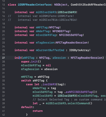

Hello again Vincent,
Reffering to my previous message, the iOSReaderSession defines a iOSRFReaderInterface.
And inside this interface the tag is recieved with asNFCISO15693Tag() function.
please, could you share your swift file ? It will be easier for my understanding.
Thx

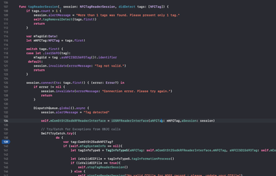

I had not seen before, but into your code, you stop the NFC session both whenever CCFile is valid or not.
This explains why all other NFC commands fails afterward.
Remove the line as follow, and it should work better :
 let isValidCCFile = tagInfoType5.tagInformationProcess()
if (isValidCCFile == true){
self.stopTagReaderSession()
} else {
self.stopTagReaderSession("No valid CCFile for NDEF record : please, update your CCFile")
if (isValidCCFile != true){
return
 hope it helps

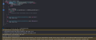

Hello Vincent,
I did the change as suggested,
But no solution still as now it crashes when checking the mailbox status,
Any idea why its still failing?
It is also every time falling into stop session state with message:
I will be looking forward to your response.
