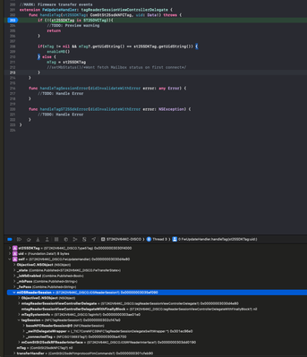

I am facing a problem with NFC reading with ST25DV64KC-DISCO board.
To integrate the SDK, I have followed the instruction over here
Even though I have imported all of the SDK files, and supporting files as well (including models, protocols and utilities).
But this same code detects the tag in original project, but in my project it fails to type cast to original form.
In specific, I get problem with following code in from "ST25DVMailboxManagementViewController"
The following condition fails in my code, but succeeds in iOS NFCTap App.
if (!(st25SDKTag is ST25DVTag || st25SDKTag is ST25DVCTag)){}
Did anyone face something similar?
Any leads will be greatly appreciated.

Hello victor,
Thankyou very much for your responce.
I am using all the same methodologies as in the NFCTap app. Infact im using the same iOSReaderSession instance as well.
Here I have also attached my debug window. (My goal is to only be able to activate mailbox.)
victor laraison
thx for info.
It would seem your type5tag is not instanciated correctly.
Have you called the function "instantiateTag" (from Model/TagInfoHelper.swift) somewhere into your code ?

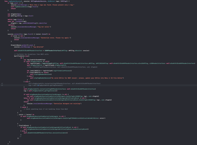

Hey Victor,
This was a very helpful thing to point out as my iOSReaderSession was never setting the product ID.
Upon further inspection, I noticed that the functionality already existed inside TagInfoHelper and TagInfoType5.
Therefore, upon detecting a tag, I now call following so that the product ID is set.
let isValidCCFile = tagInfoType5.tagInformationProcess()
                                if (isValidCCFile == true){
                                    self.stopTagReaderSession()
                                } else {
                                    self.stopTagReaderSession("No valid CCFile for NDEF record : please, update your CCFile into Menu => CC File Editor")
But sadly, even after doing that, the results are same, and the tag type cast always fails.
What else could be missing?
p.s: I have also attached code segment for clarification.
My Tag handler:
iOSReaderSession

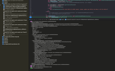

victor laraison
Hi Aly,
Please, could you send me the log of variable "tag" when you instantiate it ?
Thx and br,
Vincent
Hey Vincent,
Sure, I have attached the debug log here,
Please let me know what you find:
Thanks in advance.
Best Regards,
Aly
Hi again Aly,
I see that your ProductId is still set to ProdutUnknown.
Please, check that functions for tag identification are called correctly into your code. ref to previous post above.
