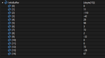

I was just playing around iso15693GetSystemInformation() function: and got this, comparing this output with F/W code, data mapping makes sense but the outcome of data does not make sense to me, any idea?
Received from Tag type-V: [HEX: 00 0B 92 D6 1C 62 03 48 02 E0 00 00 48 E4 43]

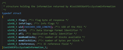

F/W Code Sys Info Structure:
Based on converting these values from signed bytes to HEX, I can see bytes[2:10] are UID, which makes byte-0 & 1 flag & infoflags respectively. Leaving last remaining 5 bytes as dsfid, afi, memblocks, memblockSize, icRef.
Where, Mem Blocks is 72, which does not look right, I would expect 512 blocks of size 4 bytes as per datasheet. This is off putting my understanding, I feel like a ***.

Hi JJ,
Reading the data sheet of ST25TV16K (6.4.22) the Get System Info is as expected: the info flag 0x0b means no block information provided, E4 43 I presume to be CRC16.

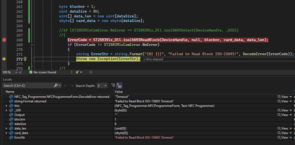

Coming back to ReadSingleBlock(), I tried supplying null for UID, but the function return back with Timeout error.

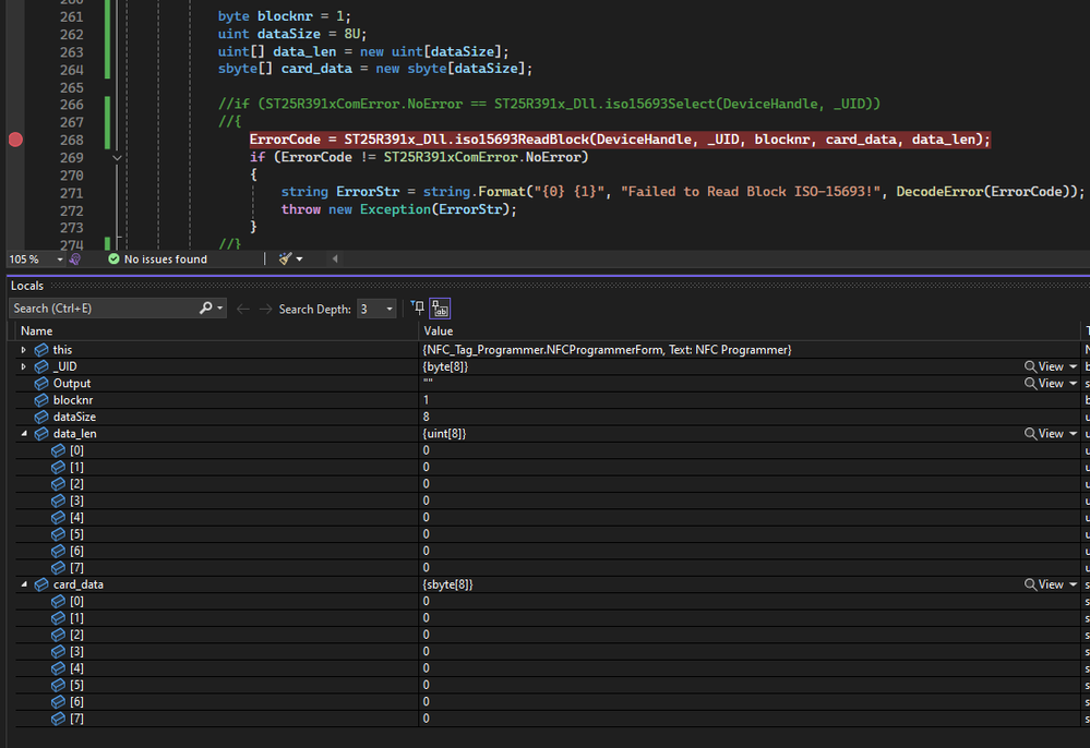

With UID supplied, function succeeds with NoError code but no data received.

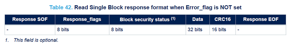

Hi JJ,
this is a C style interface. With data_len/sizeof_data you need to communicate the size of the buffer you provide to the DLL and after the function returns the data_len will be adapted to the actual returned size. You will need to feed in a pointer to a uint32_t with value of 8.
I suspect in your case the firmware was provided with a zero length buffer which it was not filling.

Thank you so much Ulysses.
I got what you mean, I was supplying wrong data_len/sizeof_data, as I had an array declared but all with 0 data by default, as soon as I corrected that I  am seeing data now. In my case as I have flashed whole tag memory with 0xFF pattern I see -1 as data which is 0xFF in HEX.
I tried WriteSingleBlock as well, and it is working now as expected. I am able to read/write single block at a time.
