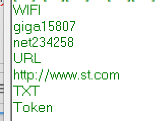

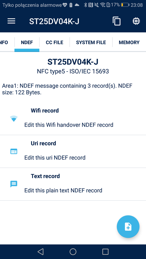

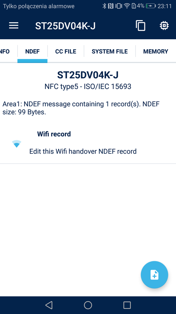

RMako.2
Hello
Thank you for all your support.
I have suceed to read and wright wifi, text and URL NDEF but problem is that I can read only one of them
Program is working fine if I have got only one NDEF in memory for example wifi - then readung is ok, but if I have got 3 (each different type) program is crash and do not read anything.
Can you suggest what is wrong?
0693W00000NpZe0QAF.pngIn this situation cannot read - I need to read all of them
0693W00000NpZeFQAV.pngWhen there is only one NDF - can read without any problem
  sRecordInfo_t record;
  NDEF_ReadNDEF(NDEF_Buffer);
  NDEF_IdentifyBuffer(&record, NDEF_Buffer);
  NDEF_ParseSP(&record *pRecordStruct);
// READ TEXT NDEF
  NDEF_Text_info_t Text;
  NDEF_ReadText( &record, &Text );
  text_read = String(Text.text);
// READ URL NDEF
  sURI_Info uri = {"", "", ""};
  NDEF_ReadURI(&record, &uri);
  uri_read = String(uri.protocol) + String(uri.URI_Message);
 // READ WIFI NDEF
  sWifiTokenInfo wps;
  NDEF_ReadWifiToken(&record, &wps);
  wifi_read_ssid = String(wps.NetworkSSID);
  wifi_read_pass = String(wps.NetworkKey);

Rene Lenerve
Hi @Community member​,
If i understand well, you are using package from arduino mbed which is using older NDEF library than the one available in ST25 NFC Lib (I think that this last one is not available for arduino mbed).
I've listed some points that may fix some issues you encounter.
  • You are using NDEF_ParseSP() function which is not a public function. This function is used to parse dedicated SmartPoster NDEF file which is not what you seemed to have recorded in your tag.
  • In the capture you have first a wifi record, followed by an URI and then a Text record. In your code the order is not the same.
  • In your code you are parsing the same record 3 times. You may add an offset of your pointer after each read of the record.
Here is an example that might help you:
      sRecordInfo_t record[3];
      uint32_t recordlength;
      uint8_t *pNDEFtmp;
      pNDEFtmp = NDEF_Buffer;
      NDEF_IdentifyBuffer(&record[0], pNDEFtmp);
      recordlength = NDEF_GetRecordLength( &record[0] );
      pNDEFtmp += recordlength;
      NDEF_IdentifyBuffer(&record[1], pNDEFtmp);
      recordlength = NDEF_GetRecordLength( &record[1] );
      NDEF_IdentifyBuffer(&record[2], pNDEFtmp);
      // READ WIFI NDEF
      sWifiTokenInfo wps;
      NDEF_ReadWifiToken(&record[0], &wps);
      // READ URL NDEF
      NDEF_ReadURI(&record[1], &uri);
    // READ TEXT NDEF
      NDEF_ReadText( &record[2], &Text );
Hope this will help you.
Kind Regards.
RMako.2
thank you that helps a lot, but stil it do not work as I want.
All is ok when I have got shor maeeage as below
but if I add a longger message data are not read correctly
0693W00000NqPXaQAN.pngI tried to manipulate with NDEFBuffer size and with calculation of buffer size but I stucked
Can you suggest something (Arduino has not debbug capability so it is hard to find what is wrong...)
thank you
