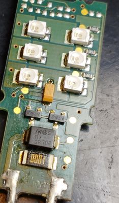

Where to find Datasheet of this component "ST G MX GP 702"?
GonzaZener
 I can't find the Datasheet of this component, any help?
Peter BENSCH
The marking MX stands for the SM6T39CA.
Regards
/Peter

I cant find its Datasheet
OK - I've edited your title to make that clear.
Peter BENSCH
