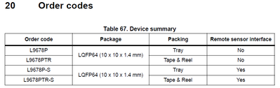

Dear Umesh,
if you don't use PSI5 sensors you can buy the L9678P part number:
