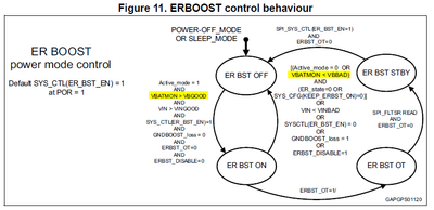

Yes, it is our suggestion to use a voltage divider.
VBATMON is used for power-up and power-down sequences, and ERBOOST enable.
It is also used to alarm the MCU in order to guarantee the correct functionality of RSU function.
2025-05-26 3:40 AM
You must use a resistive voltage divider to scale down your 28 V rail to a level within the recommended operating range of VBATMON (typically aiming for 12–16 V as a safe design margin). A buffer (e.g. op-amp or zener clamp) may also be considered depending on the precision and protection requirements.
For example, for 28 V nominal and 18 V max input:
Choose resistor values such that V_BATMON = 28 V × (R2 / (R1 + R2)) ≤ 18 V
This implies a ratio where (R2 / (R1 + R2)) ≤ 0.643

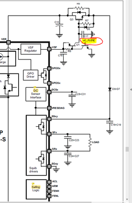

Is my understanding correct that uC_FLEN is a control signal from the MCU used to enable or disable the safing FET path (typically by pulling the gate low)?
What is the recommended driving strategy from the MCU for this pin?

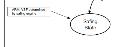

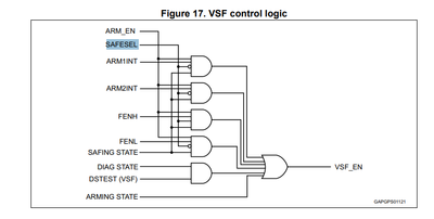

| FENH | External arming enable for high-side drivers (active high) – used when no sensor input is available, and safing must be handled externally (since in safing State ARM and VSF won’t be valid figure. 9)
| FENL | External arming enable for low-side drivers (active low) – also used when no sensor input is available, for the same reason as above |

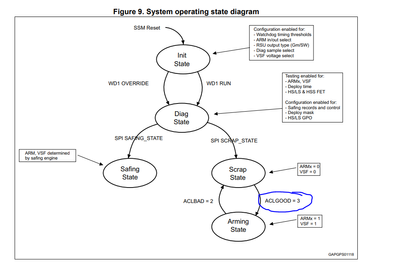

| ACL | Additional Communication Line – required to enter Arming State, as per ACLGOOD = 3 condition in Figure 9 |
| uC_FLEN | In the reference schematic, uC_FLEN appears to be used as a GPIO from the MCU to control a FET in the VSF-powered safing path — is this correct? Could this function alternatively be driven by one of the L9678P’s GPO drivers to reduce MCU pin usage? (typically near U1 as shown in Figure 58) |

In Figure 2 and Figure 58 of DS11626 you can find the typical application that can help you in understanding what written above.

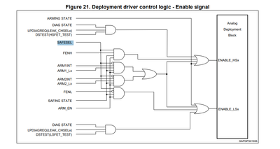

One more doubts as an application that does not use sensors, remote interfaces, or PSI5 input. Our use case involves triggering deployment logic solely based on MCU-driven signals, without relying on internal safing logic driven by sensor thresholds(we are not using in vehicle application).
In order to reach the ARMING state and assert VSF_EN, as my understanding can we rely solely on:
ACL pin: 3 valid pulses (i.e., ACLGOOD = 3)
FENH pin: High
FENL pin: High
SPI SAFESEL = 1 (external safety logic)
And skipping:
All SPI sensor data processing
All safing threshold evaluations
SPI safing record logic
Since no sensors ( because external event has in MCU and based on that wanna to deploy )
System starts in INIT → DIAG
MCU issues SPI command SAFING_STATE
L9678P enters SAFING state
MCU asserts:
ACL pulses (3x ACLGOOD vvalid)
FENH = 1, FENL = 0
SAFESSEL = 1
Device transitions to ARMING state
VSF_EN is asserted
Can you please confirm if this is the valid and complete minimal setup for entering the ARMING state when the internal sensor-driven safing logic is not used?
