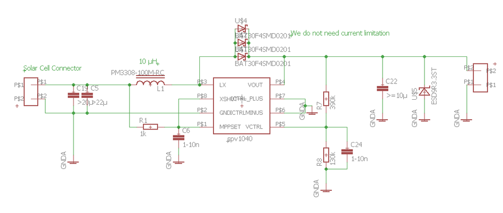

We designed a battery charger using SPV1040.
- The output voltage is fine;

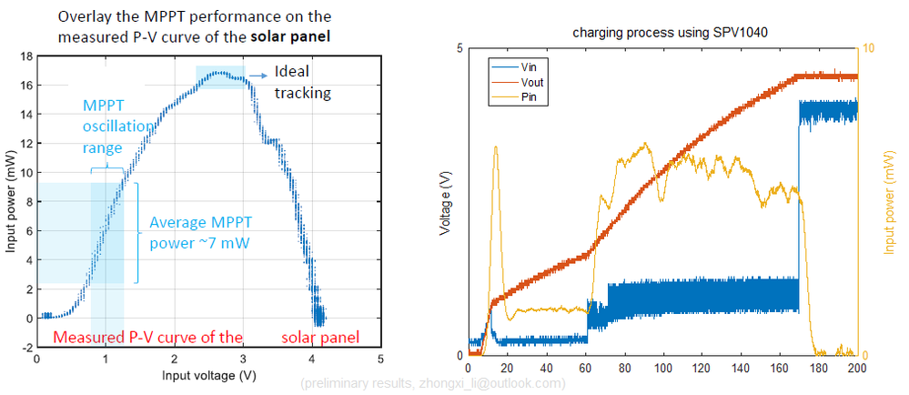

- however, during the charging process, there is a large fluctuation on the input voltage : 500mV ~ 1V. Ideally. This input voltage should stay close to Vmpp, which is 1V in our case. Since it's fluctuating, the resultant MPPT efficiency is very bad.
The diagram is attached below. Is that because we didn't settle the output current sensor resistors? The datasheet implies that it is only used for over current protection, which is not required by us so we simply grounded the I_plus and I_minus.
Many thanks for your help!

Hi Andrew, thanks for your reply.
I did some more measurements and find the following:
1. the chip's MPPT function does not need wiring I_PLUS or I_MINUS. If it monitors the output current, it does so internally;
2. perhaps our problem of low MPPT efficiency (~40%) is because we used very small input wattage (~15 mW); increasing the input wattage to 200 mW leads to 70%+ MPPT efficiency. The chip's data sheet uses >0.25 W for specifications, though.
