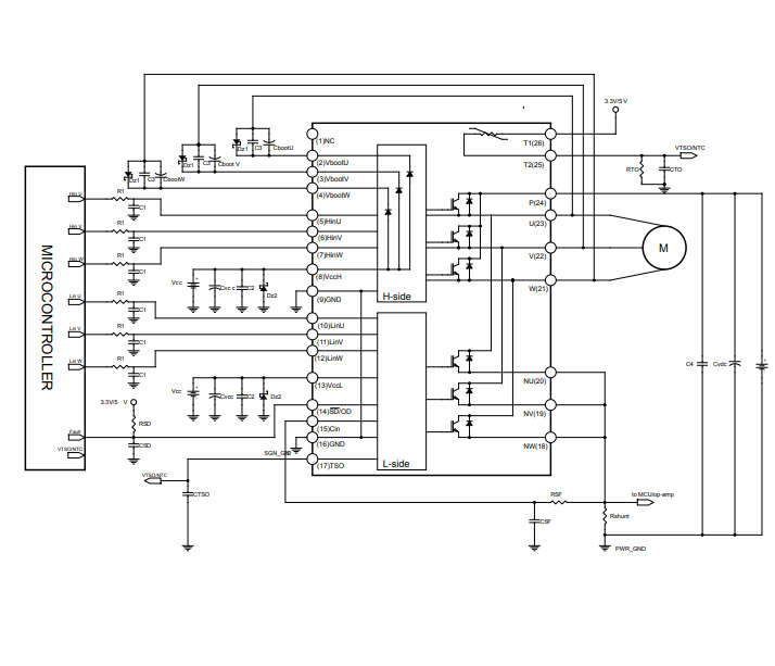

I have an IPM10F and try to switch on the gate, so I can measure a current on the Output U. My Problem is I measure nothing.
I put a constant 3.3 Voltage to the Gate-Pin A-High. On the Output (U) I connect a resistance to override the LOW-Switch. After that I tried to measure with a multimeter. I linked one end to the resistance and the other to the ground, like normal.

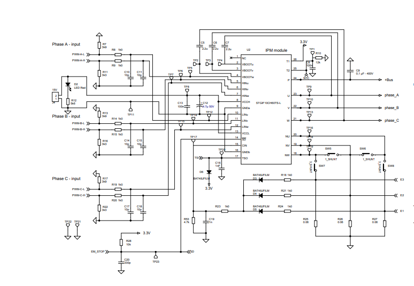

The first picture is the wiring diagram of the IGBT and the second from the STEVAL-IPM10F. I used 470k ohm resistors. After my question I tested the output by wiring three resistors 470k into a star connection and link them into the outputs (U,V,W). When I turned it on and put 400V, the oscilloscope showed how the voltage fall down, but with that current this should be impossible, so there is something wrong. Thank you! 0693W00000Uo0kTQAR.png0693W00000Uo0kEQAR.png

Please use the first configuration, I mean the config. used in your first post, if you want to turn-on the High-Side Switch (or the Low-Side).
If you want to test the High Side switch:
  1. Connect a Load resistor between U-OUT (or V-OUT, W-OUT if you want to test another output) and GND. The resistor value should be much lower than 470Kohm (ex 470ohm).
  2. Connect Oscilloscope to Out-U
  3. Apply 15V toVcc
  4. Apply 300V to DC Bus Voltage
  5. Using a Signal Generator, send a short pulse 0->3.3V (ex. 1ms) to PWM-A-H (to turn on U High Switch). The resistor power dissipation must be taken into account during this test.
If you want to test the Low-Side switch, use the same config as above but this time connect the resistor between U-OUT and P. For this test apply the input signal to the PWM-A-L input.

I tried to test the High-Side switch with your points and it doesn't work. Is there a function in the IGBT, where I have to set the Low-side of high first before the High-side?

After a few researches, I found out, that the there is a bootstrap circuit. In that case you can't control the H-Side without first charging the Bootcapacitor.
