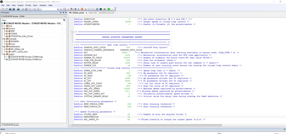

Trying to communicate to a X-Nucleo IHM11M1 demo board and the Nucleo-F401RE using Tera Term and the IHM11M1 does NOT respond to sent commands.  I am running the X-Cube-SPN11 software sucessfully by uploading it to the IHM11M1.  I can manually start the BLDC motor using the on-board buttons on the -F401RE board.  When I start the terminal emulator SW to communicate to the IHM11M1/F401RE demo boards, I get no response from the demo boards.  NOTE, when I press the reset button on the F401RE, the menu screen apprears in the terminal emulator window as shown below:

However, when I try to send any of the commands above I get no response.  Is there a special character required when transmitting the commands?  Do I need another driver to communicate to the  demo boards while the motor is running?  I am following the quick start guide to get this up and running.
I am using IAR to compile the code

I've learned one thing since this post.
1. To enter a command, just type the command with no arguments. A prompt will appear where you can input the parameter. Obviously, the coder of the interface was kind enough to not provide instructions.
