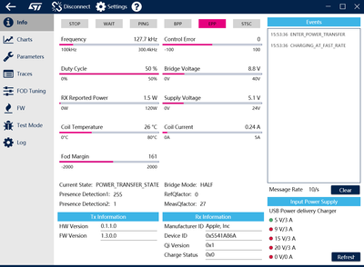

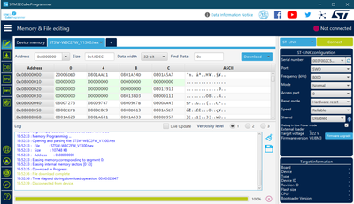

Hi All,
I have developed my own Evalboard for the STWBC2-HP based on the STEVAL-WBC2TX50. Now i have flashed the stdes-50w2cwbc_FW_v1.0.0.0.hex firmware to the board and the Software shows the following. The power transfer does not work. Do you have any suggestions why that is so?
Thank You

Hi Simon
i think you use wrong hex file, correct version is 1.3.0.0, please use this attach file.

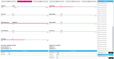

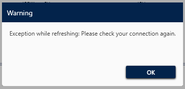

But with this hex file loaded, it is nearly impossible to connect to the IC via UART. The most time this error occurs when connecting:
Is it possible to initate the Calibration via SWD interface with the STM32 Cubeprogrammer?
After a few times trying to connect it worked, but now i get the following message: SCHEDULER-MSG-ERROR
The error log is attached.

Hi
Please erase all and download again, i have retest and do not have connect issues.
