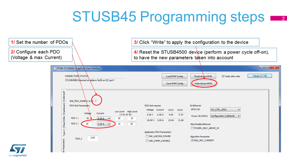

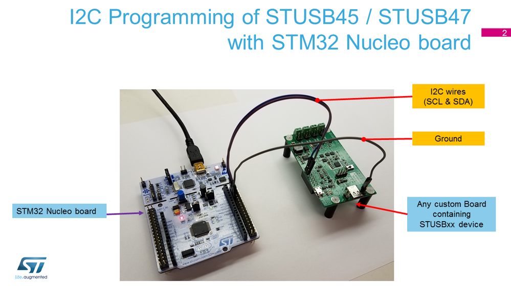

A simpler alternative to program the STUSB4500 NVM memory is to use the STUSB4500 GUI with a STM32 Nucleo board.
The Nucleo board is only $10. So it is a low cost I2C programming tool, and already ready to use.
You just need to connect the I2C pins (SCL, SDA, GND) from the Nucleo board to the I2C pins of the board where is located STUSB4500 (as you can see on the picture below).
Then you can use the GUI to configure the device depending on your application requirements.
STSW-STUSB002 : Graphical User Interface for STUSB45
https://www.st.com/content/st_com/en/products/embedded-software/evaluation-tool-software/stsw-stusb002.html

a software library called STSW-STUSB003 is now distributed. You can access from STUSB4500 product page on st.com or by clicking on the bellow link. It contains STUSB4500 hardware abstraction layers, drivers, Code example, demo as well as the detailed register map.
https://www.st.com/content/st_com/en/products/embedded-software/evaluation-tool-software/stsw-stusb003.html
