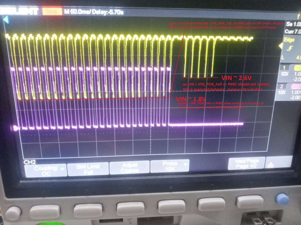

Ara.1
Senior
STPMIC1A version 0x21
CPU: STM32MP157CAA Rev.?
this is scope data
yellow is buck3 out
pink is vin
in both images
scale:
y 1v/div
anyone from PMIC div, may you let me know whats happening here ?.,
any software shall be done here ?
i am blocked now,
ChristopheB
Hi @Ara.1 (Community Member)​ ,
Thank you for the plots; PMIC behavior is understood (please download picture below to see text inserted into your plot):
0693W00000HqNr0QAF.jpgOn your plot, there are two sections where VIN drop:
  • The first is VIN dropping below VIN_POR_Fall threshold (see STPMIC1 datasheet)
  • The second is VIN dropping above VIN_POR_Fall
-1- When VIN drops below VIN_POR_Fall, the PMIC is in reset state (PMIC state machine is in 'NO_SUPPLY' state (see PMIC datasheet Figure 53)). So when VIN rises back, PMIC automatically turn ON due to "AUTO_TURN_ON" event (AUTO_TURN_ON bit is set in PMIC NVM)
-2- When VIN drops but keep above VIN_POR_Fall, the PMIC goes in OFF state (due to VIN_OK_Fall turn OFF condition). When VIN rises back, PMIC will keep in OFF state until a valid Turn ON condition. In that case, AUTO_TURN_ON bit has no effect (AUTO_TURN_ON bit has effect only from NO_SUPPLY state) => This is expected PMIC behavior defined for safety to avoid infinite restart loop in case application is powered from bad power supply source.
If you want to restart PMIC automatically after it gone in OFF state (so typically your use case), software needs to set the Restart_request bit (MAIN_CR[RREQ_EN] = 1) after each time the PMIC power ON; so after each time your application is booting-up.
