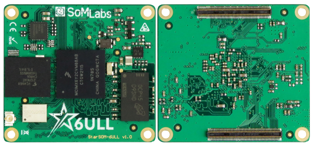

MPU, DDR3L, eMMC, WiFi+BT, microphone, speaker and display
This board appears to be close to the listed features:
The StarSOM-6ULL (SLS06) family is a SoM based on the NXP i.MX6 ULL application processor. The StarSOM-6ULL features an advanced implementation of a single ARM Cortex-A7 core (at speed up to 900MHz).
The StarSOM-6ULL (SLS06) is a low power highly integrated SoM featuring high computation power, 802.11b/g/n Wi-Fi and Bluetooth v5.1 connectivity and on-board Ethernet 10/100 PHY interface. The option of integrated, fully certified 2.4GHz Wi-Fi and Bluetooth BLE 5.1 module simplifies the carrier board. Module provides a variety memory configuration including DDR3L and eMMC memory.
The SoM supports connections to a variety of interfaces: two high-speed USB on-the-go with PHY, dual Ethernet, audio, display with touch panel and serial interfaces. In addition, the system supports industrial grade embedded applications.
Square shaped PCB of StarSOM-6ULL module is equipped with board-to-board, low profile connectors with 2×100 pins.
For evaluation purposes we offer dedicated carrier board StarCB-6ULL.
2023-08-15 11:08 AM
Thank you very much, but may I ask about the power supply for the whole system? Is it possible to power it with only one 3.7V LiPo 220mAh battery with 1C discharge rate? And if I connect it to STPMIC1 according to the schematic, is the output voltage regulation VDD, VDDQ_DDR, ... automatic? The board is supposed to be made just like the one in wearables and the only rational power supply is a LiPo battery.

The mentioned board "StarSOM-6ULL (SLS06)" has a maximum consumption of 255mA, max. 3.45 V (about 0.87975 Watts), see datasheet. What is the maximum consumption of your board?

Well, I'm still designing it and I don't know it yet, but at least now I know that battery discharge rate plays a role when designing a board, as I was't sure about that. Thanks!
