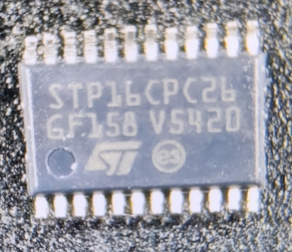

I saw that ST makes eval boards with this part, and that they include firmware to make them work, so I downloaded the firmware and copied the relevant parts to a freshly created STM32Cube project. Other than changing the I/O pin assignments, I left all the SPI bus parts alone, built the code and ran it on my board. The SPI bus peripheral worked as expected and the waverforms (other than being faster) matched what my bit-banged driver did. Unfortunately, still no LEDs turn on. I'm ordering one of these boards overnight to (1) see if they work, and if so to (2) compare signals between boards. If there's no real difference between the signals, I'll try loading my code (with different I/O pin assignments) into the eval board. If my code works on the eval board I'm not sure what to do next. The conspiracy theorist part of me got really suspicious when I saw that there's a company with a Chinese sounding name (New Yang Tech at nyang-tech.com) offering to sell these chips for a penny each. I have not yet been able to locate anything that describes the package markings so that I can see if these chips at least look legitimate. Can anyone point me to a source that explains the package markings and/or tell me if these package markings look like these chips are counterfeit or not?STP16CPC26 TOP.png
DSudo.2
I see that Peter BENSCH (ST Employee) in November 2023 answered another poster's question about component markings by telling them that this info is internal and not published.
https://community.st.com/t5/interface-and-connectivity-ics/part-marking-decoder/td-p/266605
Can anyone at ST answer my question about the component markings in the above pic?

ST online support confirmed that the part markings appear consistent with their expectations. Still no clue why SDO is stuck low even when that pin is a no-connect. I knew it didn't need a pull-up, but I tried a 4.7K one anyway and as expected it had no effect. I'm really stumped, which is embarrassing for such a simple chip. Sigh.
