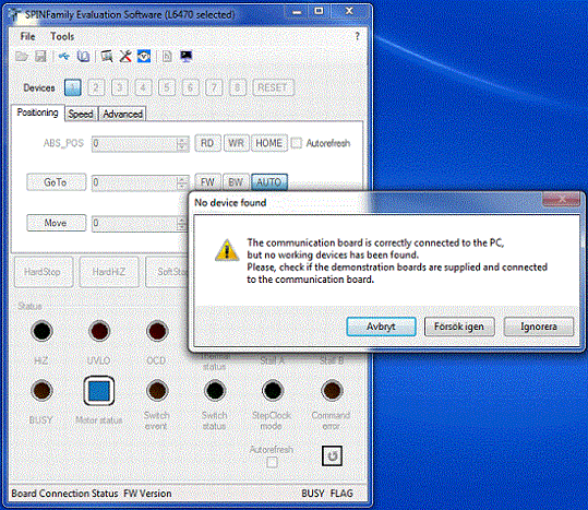

Hi, I am trying to use the PCC009V2 and an EVAL6470H board through the spinFamily Evaluation Software. but i get the following error: 0690X0000060MoVQAU.gif
I have connected the SPI_IN cable to J1 on the PCC009V2 board. A motor is connected to EVAL6470H and power is supplied.
Any suggestions what to do next?

I tried to just ignore the error and it seems to work!
Enrico Poli
March 24, 2014
Posted on March 24, 2014 at 15:30
the warning is generated because the EVAL6470H is not supplied. When you click on connect the PCC009V2 checks how many evaluation boards are connected and if no boards are found the GUI shows you this warning.
