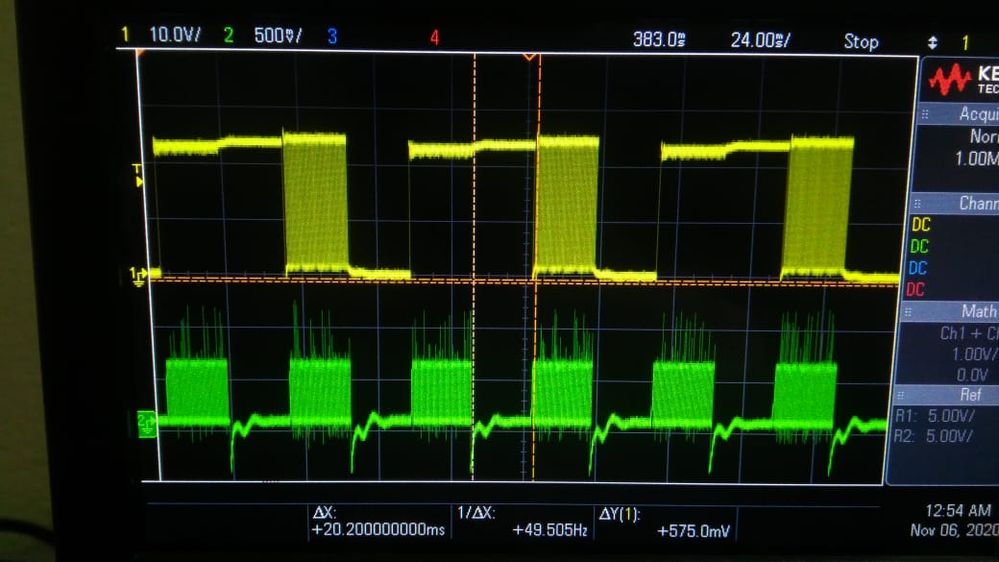

We have used L6208 for driving bipolar stepper motor in our application. We would like to run the motor in full step mode. We implemented the circuit given in the datasheet on our PCB. When we program and try to drive the stepper motor, the shaft rotates one step forward and one step backward.
  1. The clock pulse which we are supplying to CLK pin is 50ms.
  2. The following are the connections of the bipolar stepper motor with L6208 Driver
Coil 1
  1. +ve Terminal to Bridge A Output 1
  2. -ve Terminal to Bridge A Output 2
Coil 2
  1. +ve Terminal to Bridge B Output 1
  2. -ve Terminal to Bridge B Output 2
I am posting a snapshot of the waveform observed after probing the outputs of Bridge A and Bridge B of the Driver.
Bridge A - Green
Bridge B - Yellow
Looking at the waveform, I feel that one of the bridge is not functioning properly and hence this to and fro motion of the motor shaft.
Request you to kindly let me know if you know how to fix this issue.

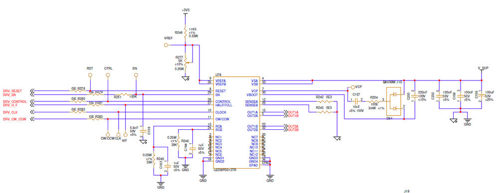

Yes, I have use the same circuit with same values mentioned in table 7 of the datasheet .I have attached a snapshot of the circuit implemented on our PCB.
0693W000005AWOPQA4.pngImage is not available
Supply voltage is 24V.Reference voltage is 0.58V. I am using a potential divided arrangement for setting the Vref.

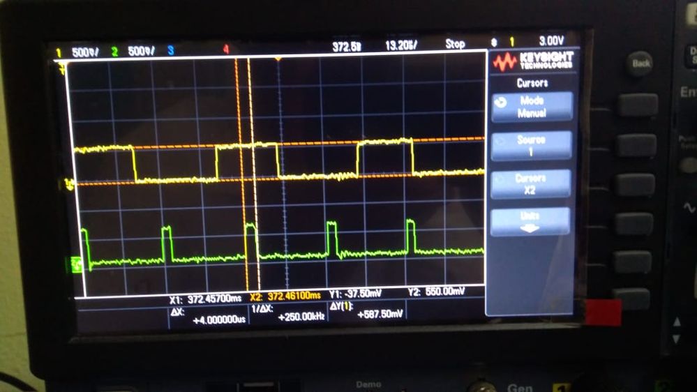

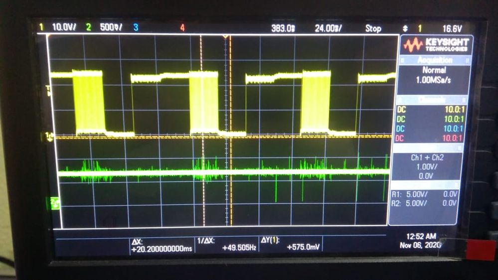

I have attached a snapshot of the waveform
CLK Frequency 10ms
Supply Voltage 24V
VREF 0.594V
OUT vs SENSE for Bridge B ( Yellow - Output Voltage | Green - Sense )
0693W000005AWLkQAO.jpgOUT vs VREF ( Yellow - Output Voltage | Green - VREF )
Please let me know if you need any more inputs to understand this issue better.

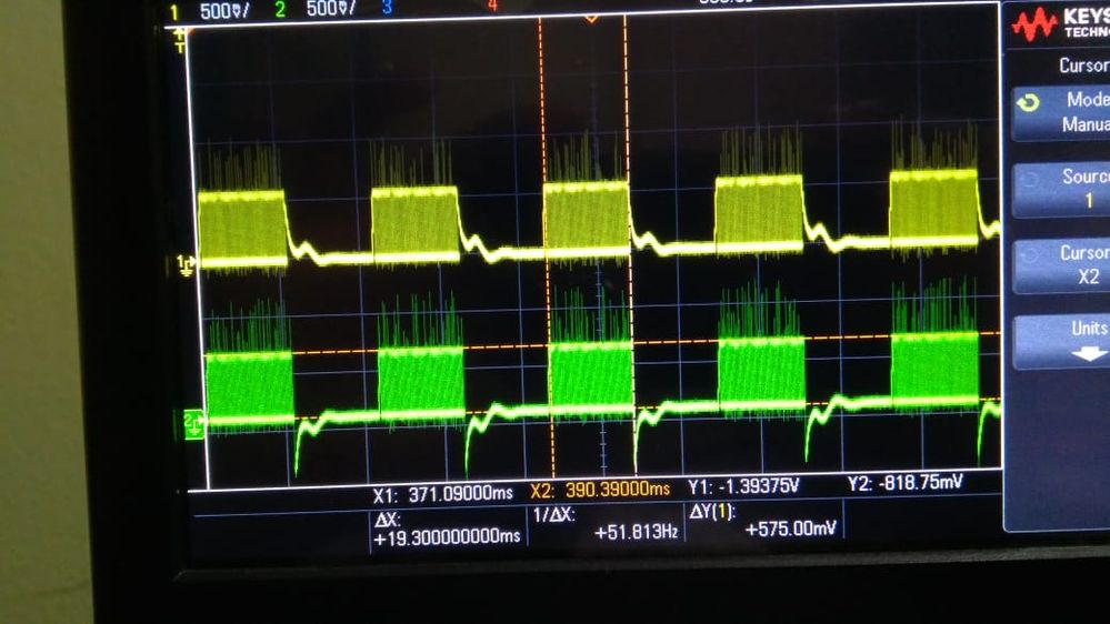

I have also taken snap shots of of both the sense signals. Adding them here just in case they might be useful.
SENSE A Vs SENSE B
0693W000005AWQGQA4.jpgClose up view of the pulses in SENSE A and SENSE B
Hello @RP.3​ ,
please check the motor connection, from your schematic looks like you swapped two OUT nets:
  • OUT2A becames OUT1B
  • OUT1B becames OUT2A
With reference to device pins, the right motor connection is: one coil connected between OUT1A and OUT2A and the other one to OUT1B and OUT2B.
Some additional notes on your schematics:
With Vref = 0.58 V and sense resistors of 0.3 ohm, the internal PWM current controller is working with OFF time of about 20us (39 kohm / 1 nF) and it set a motor current of: I_target = 0.58 / 0.3 = 1,93 A
This current value is your target?
Moreover, I would suggest you add a capacitor on EN pin.
The external RC network connected to EN pin have to be sized to ensure a safe over-current protection.
In details, you can set the disable time (time before recovering normal operation after an OC event) and the delay time (time before turning off the bridge after an OC event).
With 100 kohm and adding 4,7 nF that allow obtaining about 1us of delay time and 280us of disable time (with high voltage level of 3,3V).
Let me know if you solve the issue checking the motor connection.

Hi @Cristiana SCARAMEL​
Thank you very much for sharing your observations. You were right. The net names got changed and I was making the motor connections as per the names. I have corrected the connections now and the stepper motor is rotating properly.
I was not sure about how much current our stepper motors would draw, so i've set it to 1.9A as you've shown in your calculations.
