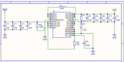

Hello, I'm new here. I'm doing a project with STBB3J components and I believe I didn't correctly understand how to calculate the resistors that control the output voltage. I followed the example of the same application circuit, which is this (page 4 technical sheet):
Datasheet: STBB3J.fm
And to configure the output voltage close to 3.3V. I used this equation (page. 18 datasheet):
Considering Vfb = 0.5V, R1 = 150K, and Vout = 3.3V, I have R2 to be approximately 26.8K. When I assemble this set of resistors, the output voltage is approximately 0.6V. As I am using the same application circuit, I believe I did not correctly understand the calculation of the resistors. If anyone could help me I would be grateful.

You have calculated the resistors correctly, but this alone is no guarantee of a functioning converter. How are EN and MODE/SYNC connected and what are the values of the passive components, i.e. coil and capacitors?

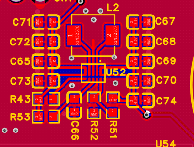

The layout also plays an important role and it would be useful to add it here for checking.

ok, below is the schematic and layout.
Peter BENSCH
Schematic and layout look good.
Now the type of the 10µH coil L2 would be important. However, the value of the saturation current of L2 and the flowing load current are also sufficient for me to assess the suitability of L2.

  • double-check orientation of U52 (dot on package at marking of the board)
  • startup according to the data sheet, Fig. 23, by briefly connecting pin E4 (EN, R43.1) to GND and releasing it again, while recording the signals at SW1 (D1...D3, L1.1) and SW1 (B1...B3, L1.2) with an oscilloscope, if possible also the current curve in L2.
