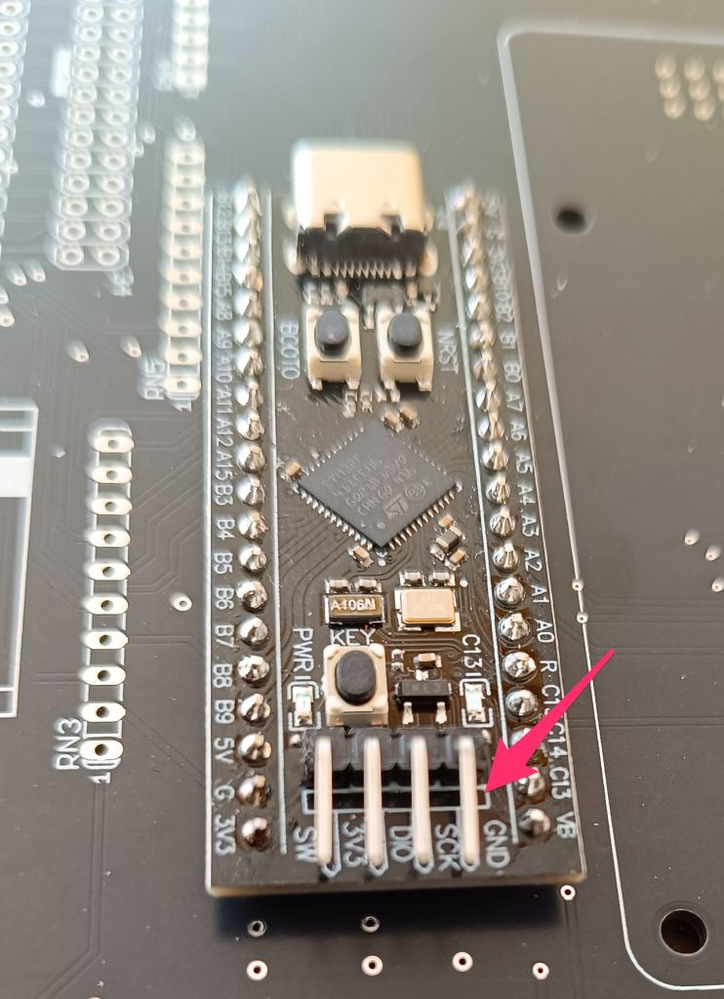

First time working with an STM32 black pill.  I have a circuit that connects a Raspberry PI (3b) to the STM32.  I am getting errors when attempting to program it using openocd via the SWD lines.  I suspect it is a voltage issue, but I don't know how to verify.
The STM32 is supplied 5v from a mini buck converter.  I measured 5v on the STM32 pins.
On initial bootup, it comes up at 3.3v, and then rises to 4.2v.   This seems bad.   The rPI's 5v and 3.3v lines measure correctly.  There are no additional power sources other than the main 12v input on the PCB.
Upon booting of the pi, an initial openocd command is issued to query the device.  this partially works:

I don't know much about the stm32, but I've been reading quite a bit about how to program, etc...  I assume that during assembly I did something wrong and damaged the STM32.
I'd appreciate any suggestions/feedback on whether I just need to replace the current stm or not, as well as other debugging options.

0x2ba01477 so probably fake MCU
The MCU shouldn't be powered directly by 5V. You should have regulator on board getting you to 3.3V. This should be powered via the USB connector.
Excessive voltages can permanently damage the devices.
You should only need to connect SWDIO, SWCLK and GND.
You definitely need a common ground with the RPi.

Hi and Thank you for the quick reply.  I have no idea where the STM32 came from.  It was part of a kit i ordered.

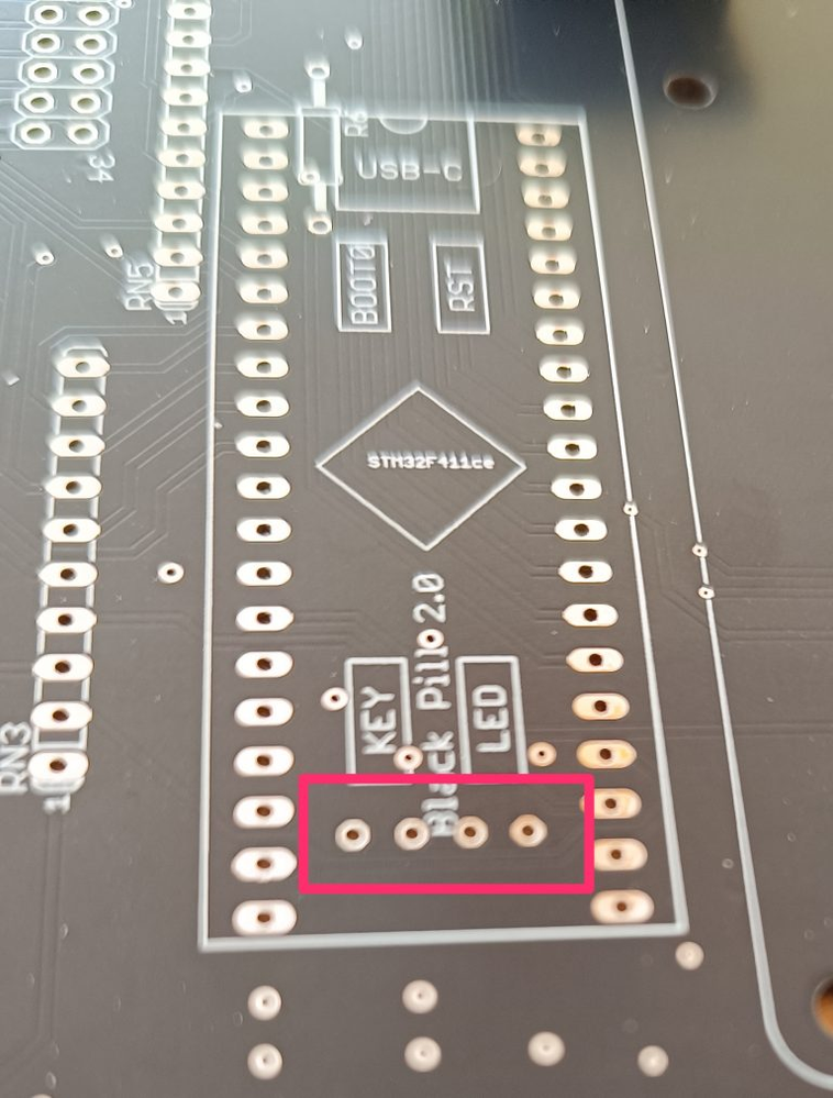

the PCB design is to take an external 12v input, which then hits the 5v DC/DC buck converter.  The limited schematics I have suggest that the STM32 is drawing 5v from the buck convertor so that the USBC 5v wouldn't be necessary.  The STM32 is soldered directly to the board ( I should have used a header... ).
The assembly instructions stated that the four pins:  3v3, SWDIO SWCLK, and GND needed soldered to the PCB.
I'm assuming the board dev used the 5v buck converter output to provide power to the MCU in lieu of making another power connection via USBC.
I certainly could remove the 5v and use a USB-C, and then disconnect the 3v3 pin if that's the better direction.
I do have a common ground with the pi.
So at a minimum it seems that the device is likely damaged due to the 4.2v.  I guess one way to validate would be to remove it from the PCB and power via USBC, then measure voltage on 3v3?

The 3.3V here is an OUTPUT, would be used if connecting to an authentic ST-LINK/V2 where Pin 1 or 2 of the 20-pin Header is expecting VTarget to drive the buffers at the appropriate core voltage.
