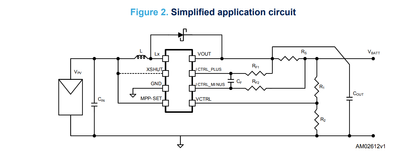

I'm trying to use the SPV1040T MPPT IC to boost up the 1.5V I'm getting from the Solar Panel to 3.8V. When I Power ON the MPPT IC its output just follows the Input and i don't see any chances of voltage getting boosted up. Is there anything wrong in the design attached? Please advise.
For now, I'm using the Lab power supply to power the MPPT IC, the O/P voltage is set to 1.5V, Current limit is set to 100mA.

from ds:
So connect the ictrl-xx to gnd, and xshut to PV+.

I did the Following modifications today and captured the I/P and O/P waveforms.  Can you check if anything still wrong to get the desired output voltage of 3.8V?
The Measurements are done with No load attached to the output of the MPPT IC.
So its working now . good !
Seems it going to "skip mode" , doing some pulses, get much voltage and stops for safety , until it tries again.
To test this, give it some load (resistor to gnd, to get about the target current, you want) + maybe a bigger load cap (470uF or so); you have to try, i dont have this chip. (So i just can tell from my experience with other smps chips.)
+ the diode CR14 should be there.

I tried to add 500uF CAP at the output of the MPPT and connected the output to an Electronic Load (Constant Resistance mode) and varied the Load resistance.
Looks the MPPT is now operating in the continuous conduction mode but, it doesn't look the desired output voltage is achieved yet.

+ pic on scope : really in + out ?? (looks like almost a short in->out )
Because almost same signal (and you have better ground now, signals themselves looking fine now.)
Sure you have diode CR14 not reversed connected ? (or try without diode, what happens then?)
Basically the chip switching now at about 100kHz , what it should do. ok , so far.
But anyway input seems to pull too much current (for your target power), i would try L -> 68...100uH (about) ,
and as input a simple AA cell, (1.5V ) , to avoid any strange limiting action from the regulated supply .

I removed the diode, and the scope plots looks little different than before.  I also tried to change the inductor value from 10uH to 33uH (that's the highest I can find quickly) not many improvements other than slight changes in the waveforms.
FYI - the VIN was probed at the Inductor Pin that connects to the Pin No 3 (LX) of the MPPT IC.
I'm suspecting if any problem in the Voltage regulation loop. I will try to change the resistor value to match with the STEVAL-ISV006V2 Evaluation board. The Values I used seems much lower than the evaluation board.
Sorry, but still in almost same as output -> chip damaged ??
output has sharp rising and falling signal = impossible with low impedance caps > 10uF there !
So check, are the caps really there and have contact to gnd (-plane) .
