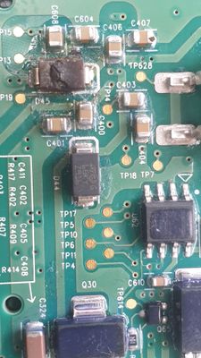

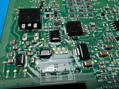

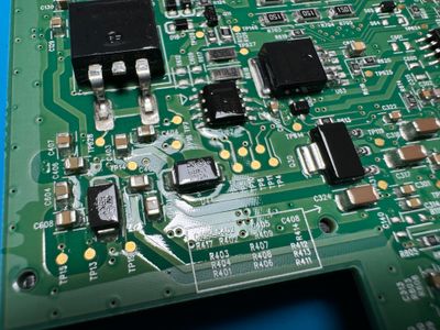

Hi Can anyone id this st device please...Its from a porsche cayenne bms module...vehicle been in a crash and this has blown....
I have id from the another identical item on the board...st-6-6bky z916...
This ive found is coming back as thishttps://www.google.com/url?sa=t&source=web&rct=j&opi=89978449&url=https://www.st.com/resource/en/datasheet/sma6ty.pdf&ved=2ahUKEwiSrozYyrqFAxWwVkEAHYO1D3MQFnoECAEQAQ&usg=AOvVaw1wQO8Fq5stC9C1efemqQeT
 Any help on this would be appreciatted...

The markings have been destroyed along with the component itself - so it's not going to be possible to identify it from that.
You'll either have to find an undamaged one, or look for documentation which identifies the component.
For that, you'll be better off in Porsche and/or EV forums

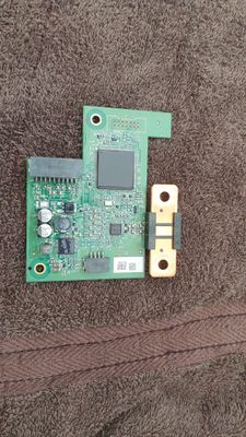

Same problem, this is two identical pices. Can you help us to identify ?IMG_3820.jpeg
Not from those pictures - the markings on the required component are not clear enough to read!
Before just replacing the component, you'd want to be sure that whatever caused it to blow has been fixed.
Also that nothing else has been damaged (even if less visibly).
