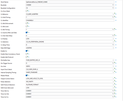

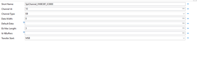

SPI ERROR BIT of Global Status Byte for VN9E30F Driver is getting triggered
Shubham_Kulkarni
Hello Team,
We are using VN9E30F High Side Driver, when we try to communicate it through SPI, the SPI Error Bit of Global Status Byte is getting Set and Reset as well.
We are Following Below Configuration for SPI:-
Could anyone help me to verify this configuration if it compatible to VN9E30F driver or not?
