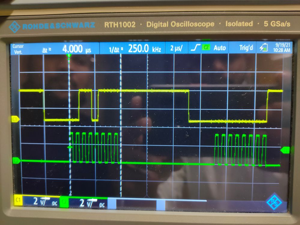

As suggested by you we tried to getStatus with CK signal (green trace) with polarity CPOL=1 and we are not getting anything (like it is giving always 0 for all the commands)
But when i change the polarity back to CPOL = 0 we are getting some garbage value.
I am not understanding this peculiar behavior of the drive and my work is getting struck in between.0693W00000DnKZQQA3.jpg

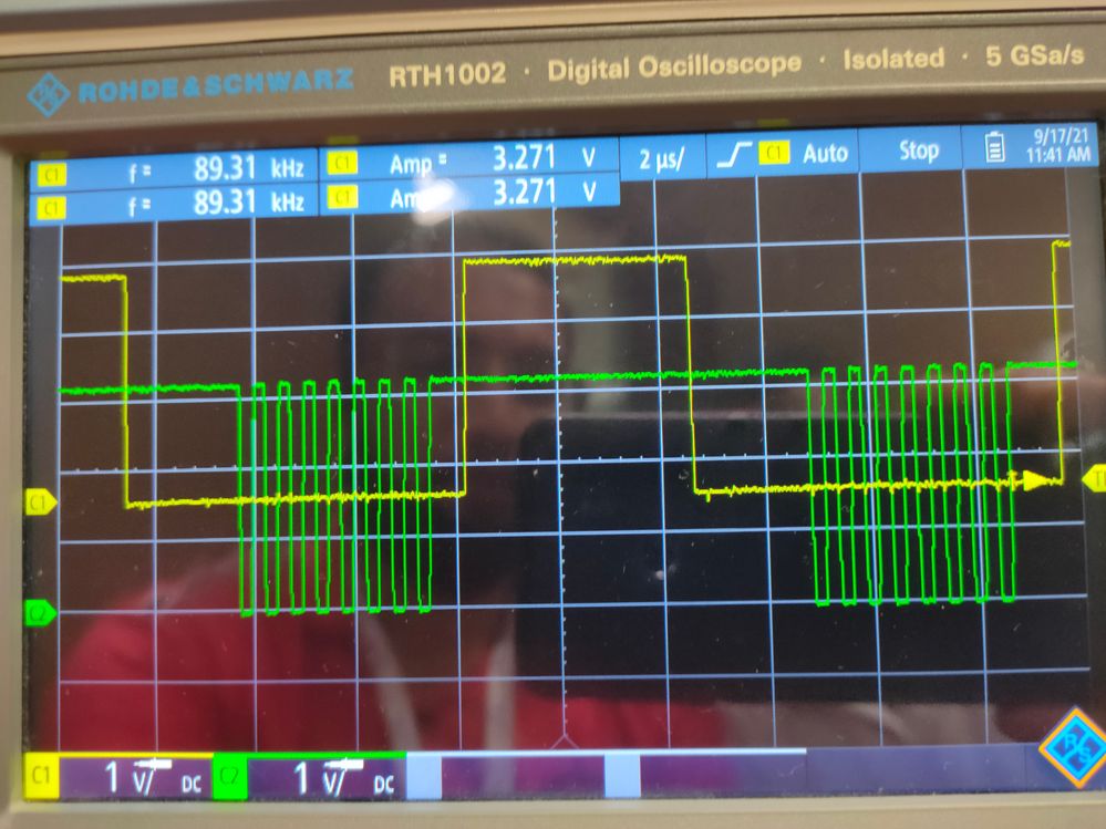

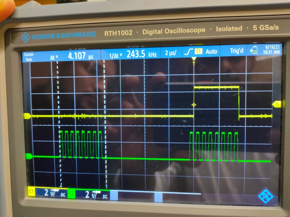

please share the timings diagram of SDI and SDO pins.
If you feel a post has answered your question, please click "Accept as Solution"
Hello @Cristiana SCARAMEL​
Attaching the timing diagrams please do check and revert back as soon as possible0693W00000DnbukQAB.jpg0693W00000DnbufQAB.jpg

Hi @Community member​,
from your pictures the L6474 is behaving properly.
If you do not configure the proper clock polarity and phase the communication fails.
You must set CPOL = 1 as above mentioned and CPHA = 1 (the IC updates the out on the falling edge and samples on the rising edge).
I attach a picture of SPI timing diagram [from wikipedia]:
0693W00000DnurkQAB.pngLet me know if with the proper setting solves your problem.
Hi @Cristiana SCARAMEL​ ​
Thank you mam I got the result what I wanted based on this settings.
