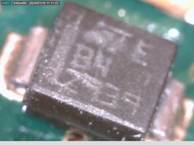

hi Peter, have looked a lot around but i couldn't found what stand for marking B4.
could you please help me?
thanks a lot,
Michele

‎2024-01-16 2:02 AM
Welcome @_mik81, to the community!
Can you please upload a photo so that the marking can be recognised?
Thanks and regards
/Peter
‎2024-01-16 2:13 AM
hi Peter,
ST E
B4
Z939
thanks a lot
‎2024-01-16 5:55 AM
This is the obsolete fast recovery rectifier SMBY01 in package SMB, which can be replaced by the (faster) alternative STTH1R04U .
Hope that helps?
Good luck!
/Peter
