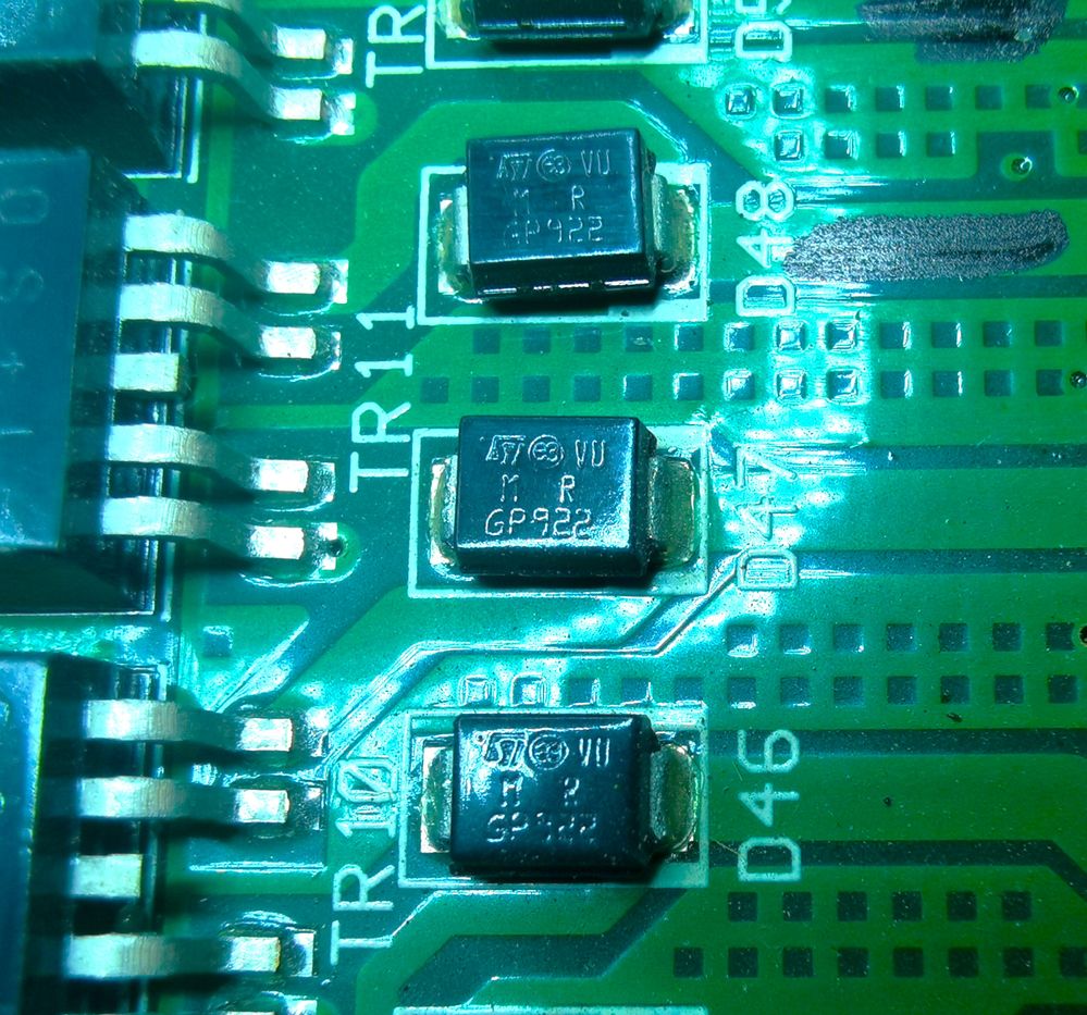

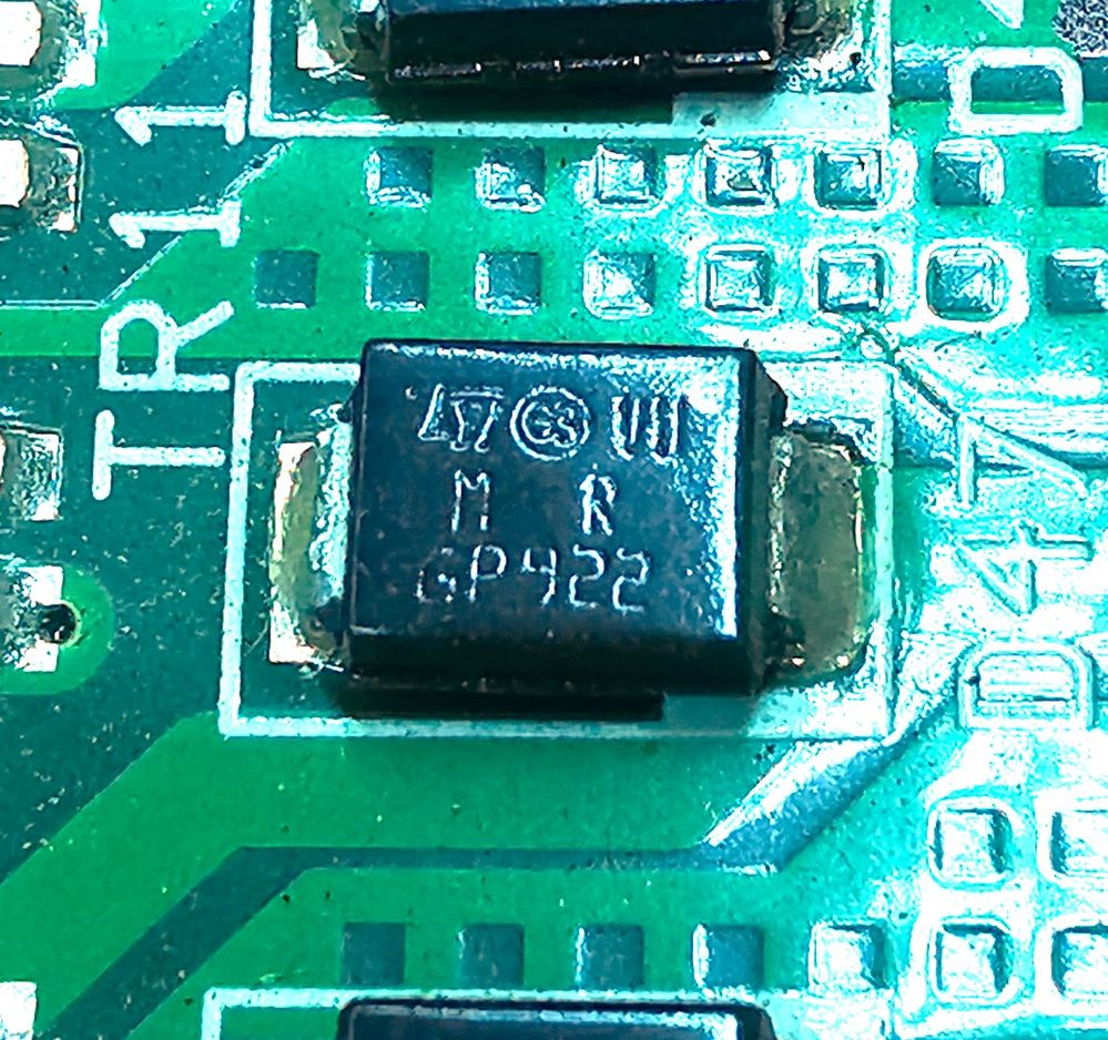

From what I can read on this diode it is from ST for sure, and it says VU beside the logo, the next line is M R, and the last line is GP922.
Any help would be appreciated.IMG_20240703_171230[1].jpgIMG_20240703_172423[1].jpg

Thank you for the legible photo!
The marking MR stands for the SM6T30CA, a bidirectional 600W, 25.6V TVS in SMB package.

Peter BENSCH
