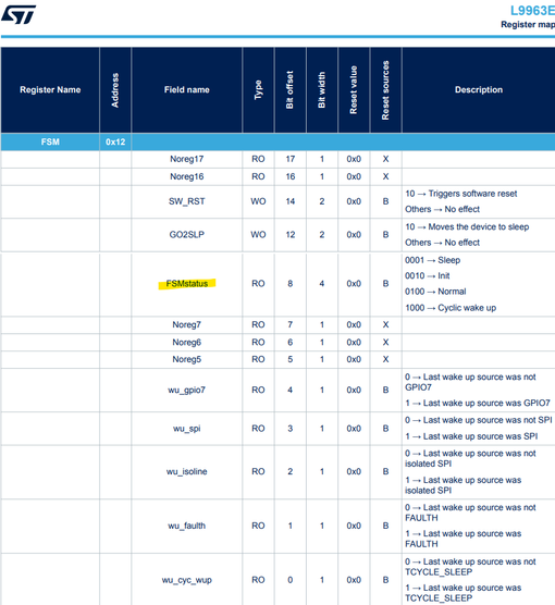

Im using the L9963E for a Battery Management System. I noticed that the device has a register called "FSMstatus". I don't understand if reports the current status or the previous status. For example, if the device is in SLEEP, in order to read the FSMstatus register, I have to wake it up, and the device goes to the NORMAL state. Now the FSMstatus reports the SLEEP or NORMAL state?

L9963E does not have any register called "FSMstatus"
FSMstatus is actually the name of a field of the FSM register [address 0x12]
This register contains the current state of the device.

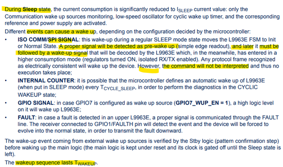

Regarding exiting from Sleep state, take a look to page 15 of the datasheet:
So, for example, two SPI transactions are required to exit the sleep state.
Probably, you "may" be able to read a sleep state if enough SPI signals are sent faster than the Twakeup.
A good solution to keep trace of the state of your device is to create a "current_FSM" variable in your code, mirroring the FSM of your IC.
Obviously, you have to maintain it updated, reading periodically the FSM register. But you can also change it manually when a GO2SLP command is sent.

Hi Simone,
thank you for all the information. Eventually I figured it out that the best way to handle the L9963E's FSM is by code and validate it by reading the FSMStatus field, as you suggested.
