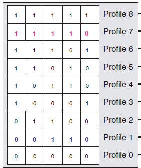

I want to control a stepper motor (
http://pt.farnell.com/astrosyn/163/stepper-motor-1-8deg-5v/dp/9598650
) with L9942 from ST.

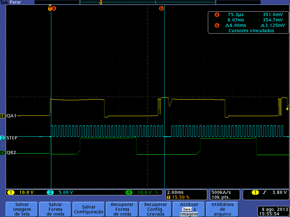

But i have some problem because the motor dont rotate uniformly (lose some step):
My current profiles are (for DC = 111 - 1300mA):
Can you help me? Why lose some step?!

The STEP signal is an input signal and it should be generated by a microcontroller or by an external circuitry.
Checking the scope-snapshot, the duty cycle of the STEP signal is not constant. this behaviour can be the source of the problem you claimed.
