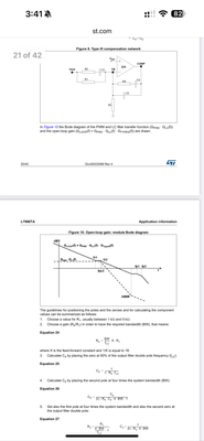

I have used L7986ta ic for 10.8V to 34V vin and Output 3.7Vdc, during light load conditions my 3.7v dips and ic skips the pulses. What i can do??

in the datasheet it is given to choose value of R1 less than 5kohm as shown in pictures, is it required to change these ba

Sounds you select Type III compensation network?
Do you have equipment can measure Bode plot?
If you didn't check Bode plot, I think you better use type II compensation network.
The compensation network impact phase, it may impact system stability.
For your case, the voltage so big range, load I guess change a lot.
This is very difficult situation, system may crush.

I have checked your design with the eDesignSuite and with your parameters I have determined e.g. a phase margin of 31.48°, which is significantly smaller than the recommended 45°.
Please change your parameters to these values:
Regards
/Peter

Thanks for your suggestions. I have made the following changes.
All other values are unchanged. This config is giving me the best results for the entire voltage range of 19VDC to 38VDC the issue regarding voltage dips is solved after making just these two changes. The system is very stable upto 30VDC i.e the ripple on 3.7V is about 60-70mV but as I increase the input voltage above 30VDC the ripple on output increases to about 140 -160mV any tips to resolve this issue will be helpful.

This ripple is also typical of the operating principle. It inevitably increases as the input voltage increases because the pulses for recharging the coil become shorter and shorter. However, you could increase the inductance slightly as a test.

Base on our testing we have finalised the following component values:
R4: 2k2
C4: 0.1uf
C5:100pf
R2: 5K6 parallel with 12k
R1: 20k
R3: 330ohms
C3: 100pF
Is it okay to use these values..?
