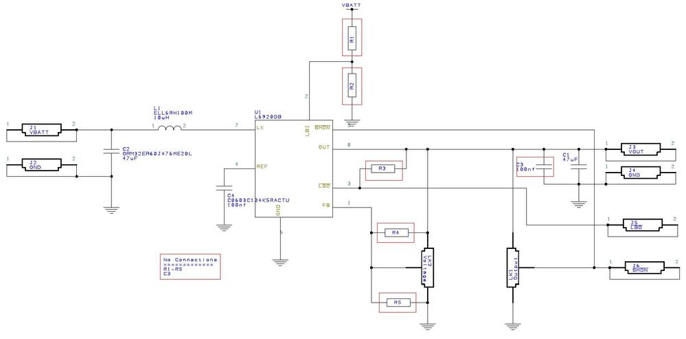

I have built my own evaluation circuit as below.  It seem to work ok when I hook it up to my bench PSU with 2.6v input and the output connected to a standard 5v LED.  Output measures 4.9v as expected.  The circuit is only populated with C1,C2,C4,L1 & U1.  Capacitors are all MLCC's.
However when I link the /SHDN input to ground the LED dims but still remains on.  My DVM says the /SHDN is definatly 0v but the output is still giving 2.0v and the LED current is 3mA.

So why does not L6920 not fully shutdown ?  It seems to be still conducting between Vbatt(7) and Vout(8) when it is in shutdown.  So how can this be correct  or useful in a battery application ?  Its just going to run the battery flat.

due to the topology, you will have the Vin-V
F
of bulk diode of high side driver (see block diagram on DS) and for sure you will not have a true shutdown...
