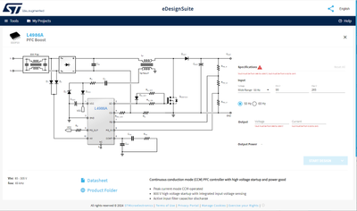

  • eDesignSuite: as I see you already used our design portal, including the Power Management Design Center and in particular the AC/DC section .

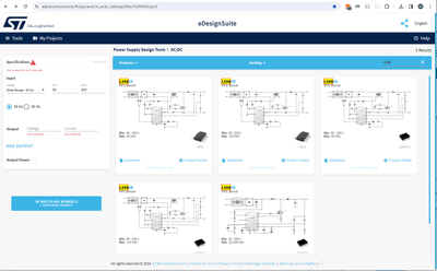

    I used the Search box to specify the Part Number and filter the list of design solutions, including L4986A PFC Boost design (see the screenshots below) .
    Can you please clarify the point where you write "The eDesignSuite for l4986A have a limits for the design specification and I could not input all of the design variables."?

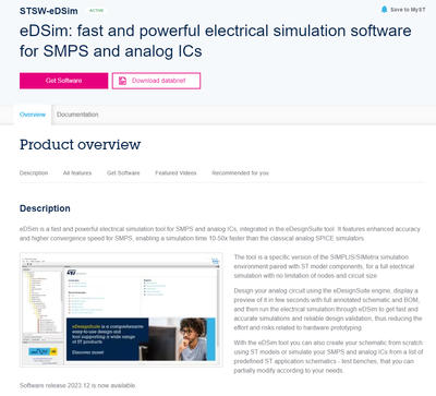

Furthermore I wonder if you know eDSim, a free version of SIMetrix/SIMPLIS tool, offered by STMicroelectronics to allow the customers to run simulations on many designs based on a set of our products.
You can download eDSim from: https://www.st.com/edsim (see the screenshots below)
