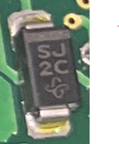

Please can you help me identify this diode
authorleon
It is out of a Citroen C3 SX 03 BSI relay/fuse car unit
5 REPLIES 5
Vishay S1J
https://www.vishay.com/docs/88711/s1.pdf
authorleon
Hi, not to doubt at all. This is definitely the one.
Is this the one I have to get?
https://www.digikey.co.uk/en/products/detail/vishay-general-semiconductor-diodes-division/S1J-E3-61T/1091468
I link to exactly what I need would be great.
Thank you
Yes, that is exactly that device.
