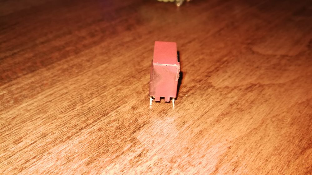

Hi everyone,
I have a power supply I'm trying to repair and have removed a Kaschke component that I'm unable to find a datasheet for.
Is anyone familiar with with manufacturer that can help me identify this component?
"KASCHKE 044.129"

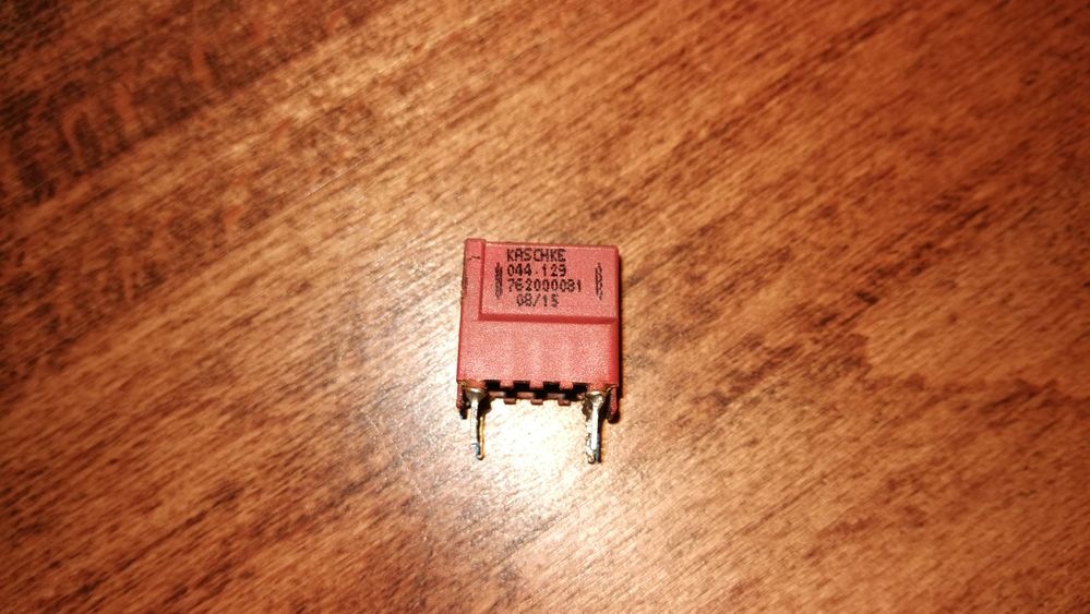

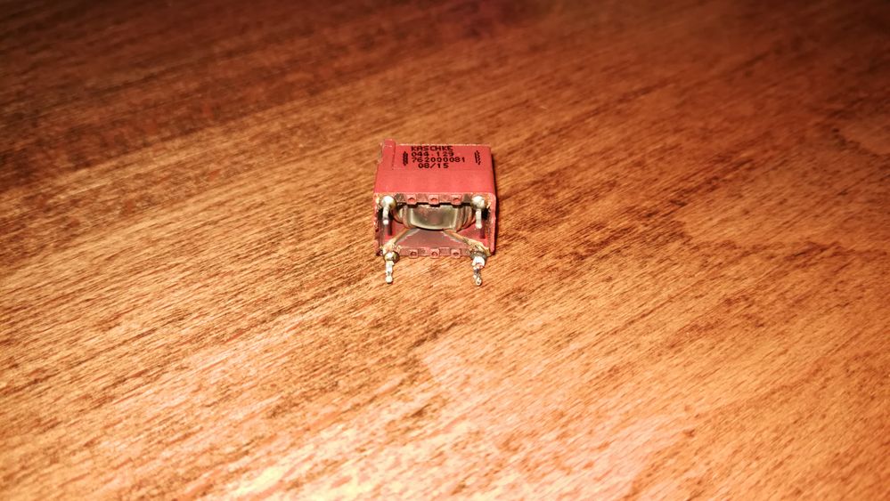

I don't have some of the info with me that you've requested, but I have a few pictures that are hopefully helpful to you.
I believe it is some type of inductor - it has 4 pins. I'm not sure what exactly it's purpose is in the circuit.
The power supply is out of an automated light fixture (entertainment industry).
Common Mode Toroid Choke, perhaps custom, you'd likely need to measure one not blown up.

It's some filtering choke, which will almost never fail. Why did you even solder ir out? It can be checked with multimeter inside the circuit in like 6 seconds. A "repair" by randomly soldering out some components rarely leads to success. And, if the power supply is of SMPS type, then the hope of fixing the power supply by replacing some single passive component without understanding how the power supply works, is naive. Apart from aged electrolytic capacitors, almost always the source of the trouble is some damaged semiconductor and then possibly other components as a consequence.
