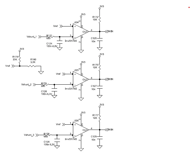

Now I am sitting in front of two blown MOSFETS (phase A) on the motor board. Actually the OCP should pull the BKIN pin from logical 3.3V to GND when the current is greater than 30A. Which would then cause the PWM signal at timer 1 to be turned off
See UM1996 (Getting Started with the IHM08M1). On page 17/29 the following is written: "Over Current Protection (OCP) is implemented by hardware with a detection circuit. The current is compared with an embedded current reference (by the MCU) and the output generates a fault condition at the BKIN pin that goes to ground. This pin, connected to STM32 Nucleo board (BKIN Timer function), detects this condition and immediately disables the driving signals (see the schematic below)."

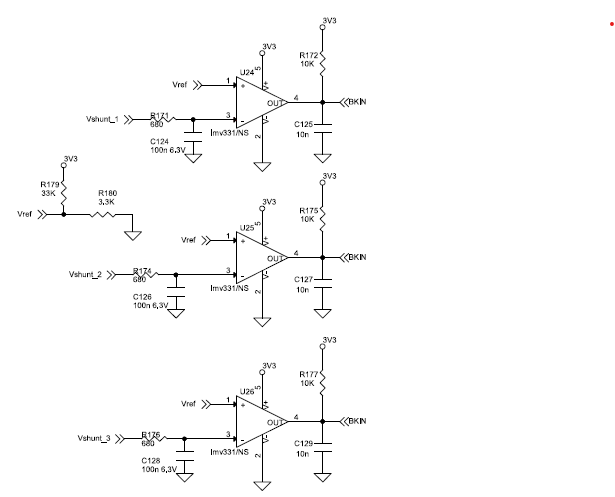

According to Figure 12, the electronic circuit is as follows:
0693W000007Dzu9QAC.pngIf I understand this correctly, the reference voltage Vref for the OCP cannot be set (via a signal from the MCU), but is always according to the simple voltage divider 3.3/11 = 0.3V. Which corresponds to a limit current of 30A with a shunt resistor of 0.01Ohm, where BKIN from 3.3V to GND is set.

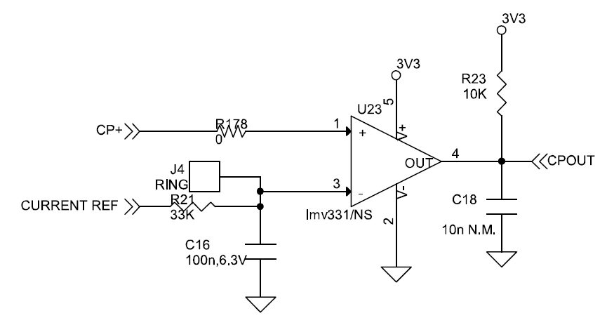

Unfortunately this mechanism does not work. Even at a current of 40A BKIN is still HIGH (3.3V). That's why the transistors of one phase have been destroyed in case of a controller fault now. I made a cross check by applying for the signal CURRENT_REF at pin PB4 (CN10_27) the for 30A corresponding reference voltage (30A*Rshunt*5.18). As soon as this current is exceeded, CPOUT at pin PA12 (CN10_12) switches from GND to 3.3V. So the current is obviously detected correctly via the shunt resistor (which is also confirmed by the readout of the Curr_Fdbk signals at the ADC).

You are right the reference voltage Vref for the OCP is set through the R179/R180 voltage divider.

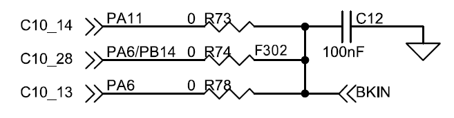

In the X-NUCLEO-IHM08M1 board all the MCU signals and power pins are available on the ST morpho connector. The BKIN signal is mapped to the connector CN10 on three different pins: C10_13, C10_14 and C10_28. According to your STM32 Nucleo-64 board you can use the proper connection through the available solder bridges.
This is exactly how I understood it. According to figure 10 on page 15 in UM1996 the outputs of all three OCP circuits are connected (resistors R73, 74 and 78 are all soldered in the delivery state of the IHM08M1). That means triggering one of these three comparator circuits from my first post (detect an Overcurrent by HW) would also affect all three pins equally (pull all from HIGH to LOW)?

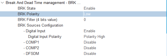

I have connected pin C10_13 (PA6) of the IHM08M1 to pin C12_16 (PB12) of the NUCLEO-H743ZI2 Morpho Connector (soldered the pin rows by myself) configured as TIM1 BKIN1. The BRK polarity is set to LOW.
I think this configuration should actually do it. Nevertheless, even with the test load of 40 A and the voltage measurement of pin C10_13 (PA6) of the IHM08M1 with an oscilloscope, no OCP signal was detected here (edge from HIGH to LOW).

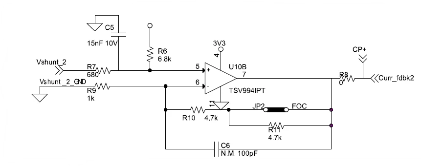

Firstly, because the comparator circuit shown in Figure 9 (page 14) works reliably after set a corresponding CURRENT_REF Signal (e.g. for 30A):

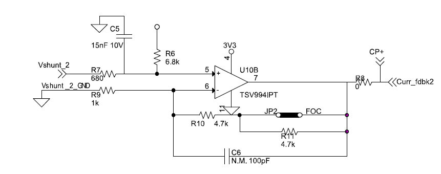

CP+ here is identical to the the voltage point Curr_fdbk2, which in turn is the output of the current measurement circuit with input voltage Vshunt_2 (Figure 9, page 14):

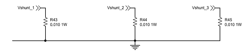

Vshunt_2 is also the rerference signal for the middle OCP circuit with BKIN as output (see the picture in my first post). Vshunt_2 drops across shunt resistor R44 (Figure 13, page 18):

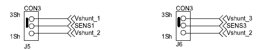

 0693W000008GLtvQAG.pngWhich leads me to my second point. I am running the IHM08M1 in 1Sh mode. Thus J5 and J6 are soldered (as shipped) so that SENS1 and SENS3 are connected to Vshunt_2:
If I have understood all this correctly, the entire load current in this 1Sh configuration thus flows at all times via the point Vshunt_2 or respectively through the shunt resistor R44. Independent of the switching state of the three half bridges. Because between the fictitious ground of the pulse inverter bridge (SENS1-3) and the actual GND there are still the shunt resistors R43-R45. Depending on the connection in J5 and J6, these resistors are either connected to the active motor phase in the 3Sh configuration, and are only energized when the lower transistor of the corresponding half bridge is active. Or, as already mentioned, in the Sh1 configuration the entire current is always conducted via R44 (Phase 2).

Do I need to remove any resistors perhaps? I am confused by the fact that all three outputs of the OCP circuits (picture last post) end at the same voltage point BKIN. Which according to Figure 10 is connected to all three pins. In a 1Sh configuration, wouldn't the two unused OCP circuits (phase 1 and 3) always pull the BKIN signal HIGH (regardless of whether the OCP circuit of phase 2 has detected an overcurrent and set its output to LOW). Or is a LOW output sufficient to automatically pull BKIN to GND (regardless of what the other two circuits have as output)?

concerning to the BKIN signal, usually one of the three C10 pins of the X-NUCLEO-IHM08M1 is kept solder according to your STM32 NUCLEO (the others two removed e.g. R73 and R74).
In your case the important thing is one of them is correctly mapped in your TIM1 BKIN port (PB12). The polarity active low is right.
The "OCP circuits" that generates BKIN signal are made with comparators with open-drain outputs suitable for wired-OR application, so it only one of the three comparator outputs goes low to pull-down the BKIN signal.
My previous question about the total load current assumed a 3Sh configuration.
If you are working in single shunt topology (J5 and J6 closed on Vshunt_2) your assumptions are all correct. It is not necessary remove any shunt resistor.
