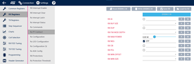

I use the STWLC38 for wireless charging.
Just set the BPP VOUT to 9V, and other REG is in default value.
In test , the output current around 0.6A . (The chip emits a squealing sound)
If I want to set the Rx to 15W, which REG I need to set.
And I have a question about the RX LDO configuration in datasheet。 There is no detailed explanation regarding the threshold. How should these registers be configured?
Thank you!

please enable RX NEG for EPP mode use GUI, or you can use this link epp file.
https://github.com/STwirelesscharger/STSW-WPSTUDIO/blob/main/a12_wlc38_downfw_epp.bat
