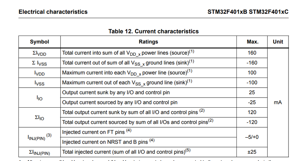

KaushikThumar
0693W00000KdVn2QAF.pngNot sure about Minimum Current, but as per STM datasheet the maximum current rang is up to 25mA. you can see it in the datasheet page 58, Arm® Cortex®-M4 32b MCU+FPU, 105 DMIPS, 256KB Flash/64KB RAM, 11 TIMs, 1 ADC, 11 comm. interfaces (st.com). I search it, and assume it ranges from some uA to 25mA.

Does your question refer to the fact that you want to drive a GPIO pin as an input and know the minimum current for it?
Or are you asking about the minimum current that a GPIO can drive into a connected load?

I think he/she asking for threshold voltage on GPIO pin to read it as one , which is around 1.8V maybe.
