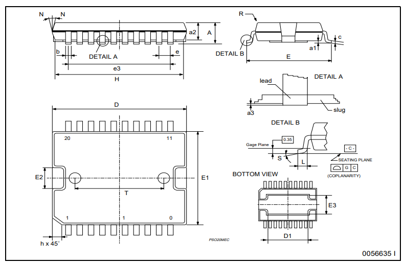

Hi, I want to know the exposed pad connection of LP825 IC. Is it connected to GND?

    0693W00000Y8UseQAF.pngNo information is given in the datasheet about the Epad connection.

    Peter BENSCH
    January 18, 2023
    Ah, you're talking about the L9825. I have no information about its exposed pad, but it should indeed be connected to GND. This should be confirmed by a measurement between pin 1, 10, 11 or 20 to the exposed pad, which should give ~0ohm in each case.
