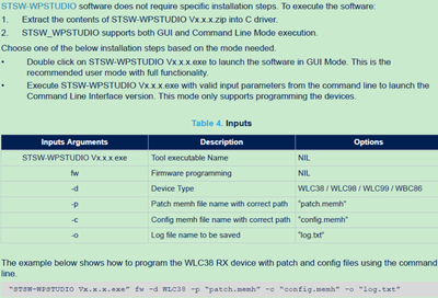

thank you for the logs, can you follow UM3164 STSW-WPSTUDIO user guide.pdf and test again.
