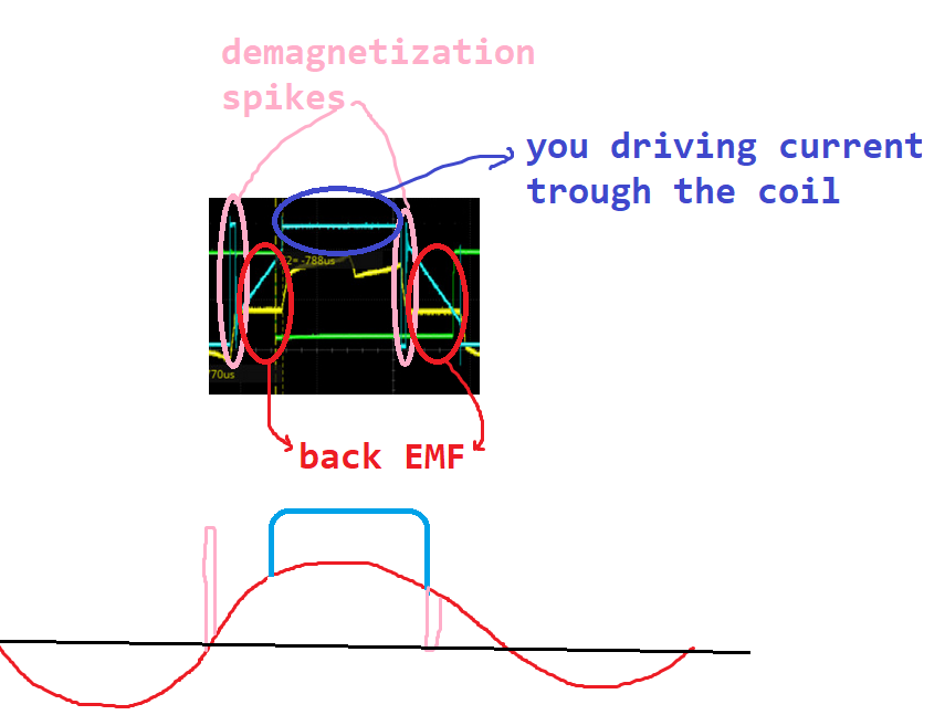

@ausera uirwaij​ There is nothing wrong with that "jump", that jump is the BACK-EMF readings trapezoidal modulation relies on for coil position/ electrical speed calculations.
The faster your motor goes and the lower your MOSFET/IGBT resistance the higher the backEMF signal would be seen.
The "jump" is there because the second picture motor is running at lower speed for some reason. (if the haware is different and youre driving both 100% there you have it, your drive board is able to put more current into the motor than the comercial one)
One way of filtering Current ripple (your sistem is missmatched) is to add Filtering capacitors to match your IGBT/MOSFET with the coils
https://www.planetanalog.com/capacitor-choices-in-power-related-applications/
I bet this happens because your IGBT/MOSFET is way faster (its like slamming the door of a room instead of gently closing it) than the comertial solution youre comparing it to, and has lower ON resistance.

Hello @Javier Muñoz​ ,
Thanks for your professional reply. It helps me to understand the underlying principals.
Both pictures are captured at 100% duty cycle,However, my board running at 10200 rpm lower speed than the commercial one which has 10800 rpm with the same 24V supply voltage. We have different hardware configures but the same hardware architectural. So both running at similar speed should have the similar back-EMF voltages, my board's picture seems higher back-EMF voltage than the other one from the aspect of voltage "jump".
I bet this happens because your IGBT/MOSFET is way faster (its like slamming the door of a room instead of gently closing it) than the comertial solution youre comparing it to, and has lower ON resistance.------->
my board is shipped with STM32F427x and the commercial one is MCU made by local manufacturer.
Can you explain what're ways can result in such way faster for stm32 and how to switch my MOSFETs gently? faster way causes what results? I may agree with your words because I shut off and on MOSFETs once hall edge triggers.

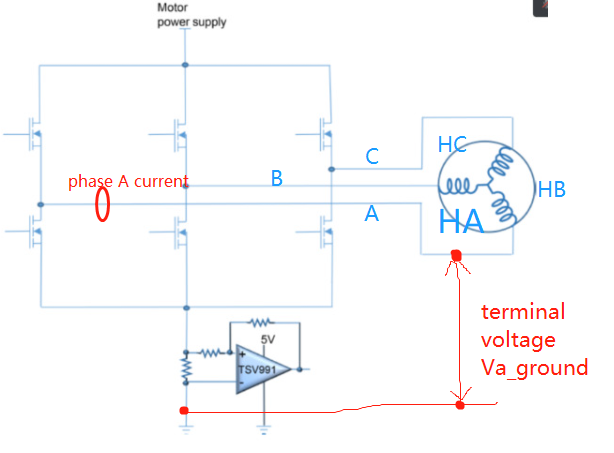

If you want to explore that option anyway, ¿could you post a picture/schematic of where are you probing your oscilloscope?, more info about both setups in general.

I'm sorry and I got off work , I draw a picture to describe my probing position.
0693W00000HozbwQAB.pngI probe phase current ,terminal voltage and hall sensor of phase A using oscillator showed in above posts. HA,HB and HC is 3 hall sensors.
I dont see that the difference between the back-emf and the driving voltage ("jump") should be a problem.---->
I just wonder to know how 6step commutation has lower back-emf voltage compared to my board, 120°commutation has no flux weakening like FOC after all. Is any possible suppress or discharge back-emf voltage by hardware? I think if my board has lower back-emf voltage will speed less current to counter back-emf and has higher speed like commercial one.
