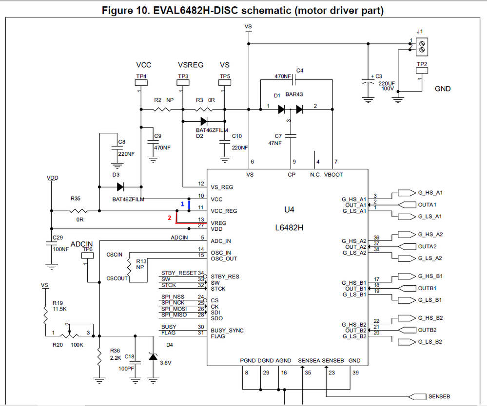

I think there is a mistake in the scheme:

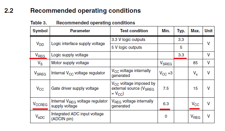

Checking data sheet (and a board built by myself), the red line (2) is wrong, and it is necessary the blue line (1).
I have destroyed 3 L6482 chips before to find out what was happening.
Now, who pays my three L6482H chips...?

i am also working on L6480 Stepper motor Driver.
i also follow the diagram from the eve board.
so now i am getting confuse.do i need to follow your diagram or orginal means eve board diagram.
i hope St support will give us some reason of this issue.
