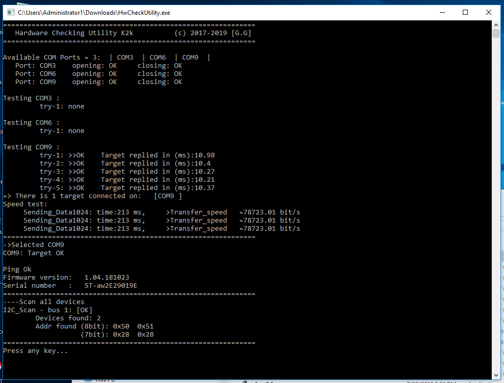

I have checked and re-checked this. Also used another USB to I2C converter and can read the registers just fine. Put an I2C analyzer on the setup and I see no activity when the GUI program starts.
Today on Github I found a HwCheckUtility.exe file. It launches, finds the com port and then indicates it found the I2C device at 0x28 address. I also see the scan on the logic analyzer.
I am now at a loss as to what do next.

There is a known issue with the GUI on some computer configuration with several COM ports, where the port on which is connected the Nucleo board is not detected automatically.
Please use the updated version attached. It should resolve the port detection.
Check also that you have VC++ 2015 runtime properly installed.

Thank you for the new GUI. I used the latest one and it is now talking to the development board. So it looks like my problem is solved.
NOTE: On my Lenovo laptop (WIN 10), I had to install the 32 bit Microsoft Visual C++ 2015 Redistributable Update 3. Even though this is a 64 bit laptop, it wanted the 32 bit dll. No problem, it works which is all I want.

Actually the GUI Application needs both 2012 and 2015 version of Microsoft Visual C++ Redistributable 32bit (x86).
Sorry for the confusion, the documentation on ST.com is not up-to-date. I will report it.
  • To check the Hardware connection of the PC with the Nucleo board, you can use the attached command-line utility (HwCheckUtility.exe)
This utility is simple and doesn't need VC++ Redistributable.

  • To be able to use the STM32 Nucleo board properly, be sure to program the board with the correct firmware (by dragging-dropping the .bin file).
When the Nucleo board is ready, the LED2 must be blinking. If it is not blinking, there is an hardware issue, and the GUI application will not be able to connect to it.

Thanks for this. With 1.07, board not found but HwCheckUtility 1.0.0 found my ISC005V1. With 1.08, I can now see the board.
