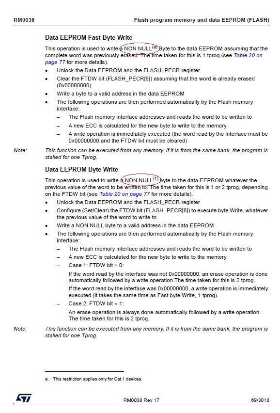

This is the page of the RM I’m talking about:
The device I’m using is a CAT.1 (STM32L151C6T6 or STM32L152C6T6)

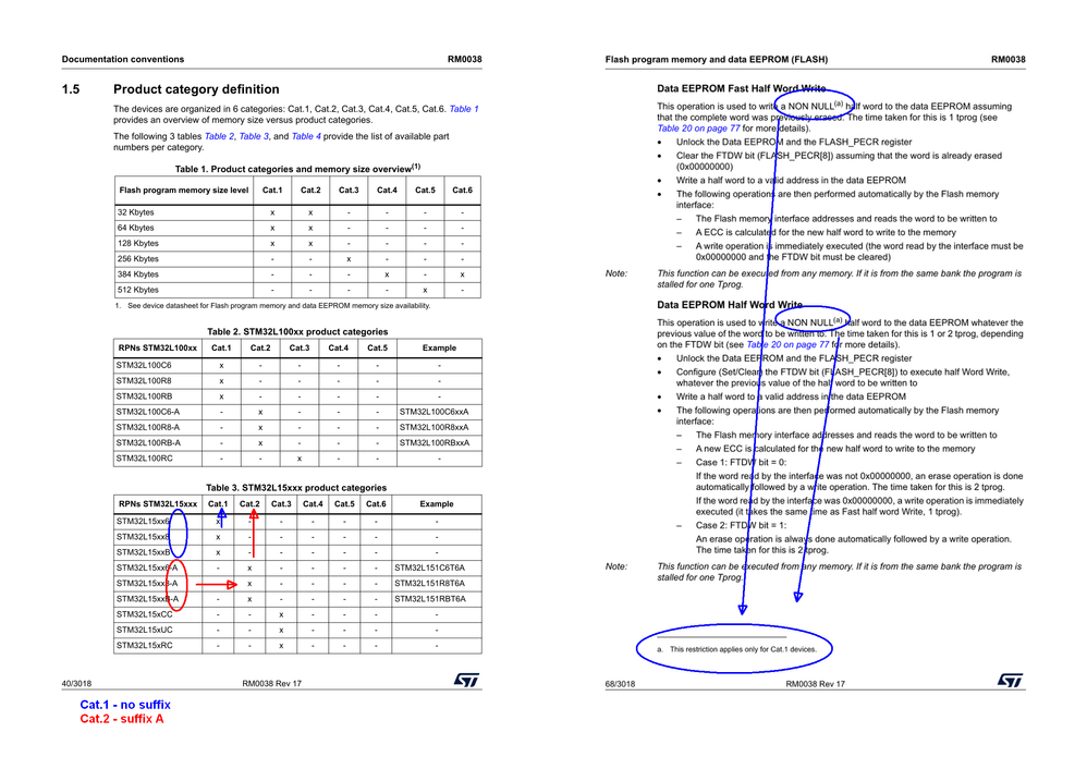

Note, that i the 'L1 family, there are A-suffixed parts, which may behave differently in some details than their non-suffixed counterparts​.

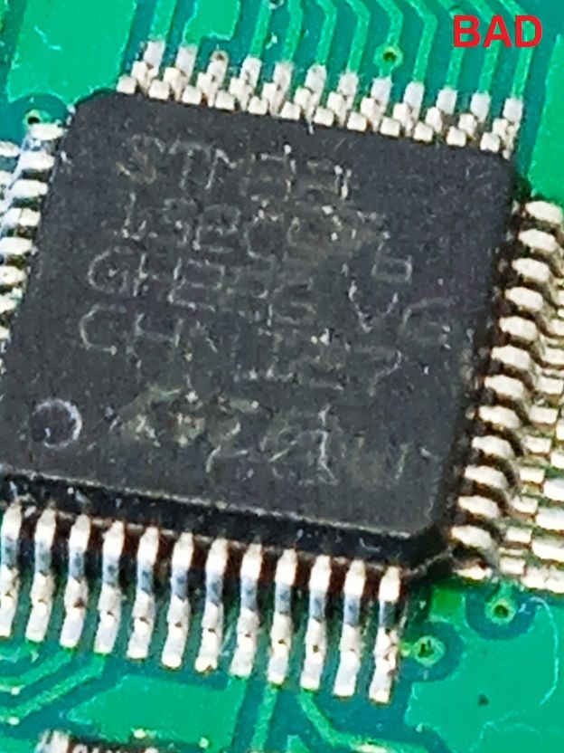

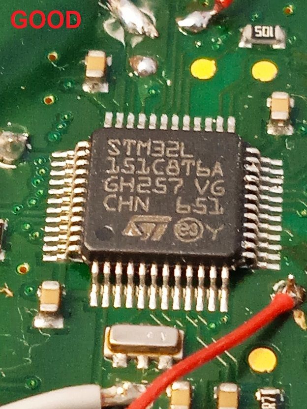

Post photos of "good" and "bad" chips.
JW​
AMott.1
Indeed it seems that the "A" parts don't suffer of this problem. But it is not documented in the manual... Can we trust that "A" parts don't show this problem?
waclawek.jan
It is:0693W00000QMNMrQAP.png@Amel NASRI​ ,
