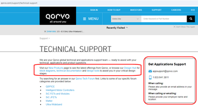

So have you contacted Qorvo support?
‎2024-10-23 1:49 AM
yes , did that too . No response till now
