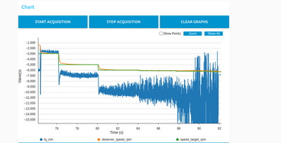

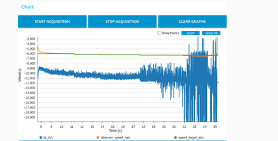

    I also tried to :
    - increase the sampling time of the ADCs
    - change the opamp op speed from "NORMAL" to "FAST"
    - reduce the gain of the op amp to lower the amplification of noises (at the cost of a lower resolution on my ADC)
    The gain reducing seems to give a slightly better solution but mind-blowing.
    I join a few graph of current and rpm made with cubeMonitor.
