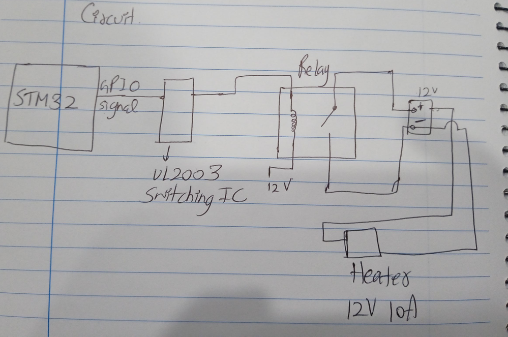

 I am controlling Relay which controls heater using the switching IC here is my overall circuit.The coil voltage is 12V

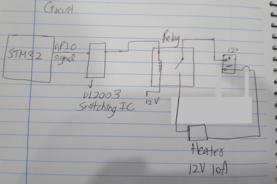

PS:
As shown, your heater is permanently connected to your 12V supply, and your relay shorts-out that supply.
I presume you meant (something like) this:
yes?
