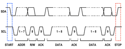

  • A start condition is defined as a transition from high to low on the SDA line while the SCL line is high.
  • A stop condition is defined as a transition from low to high on the SDA line while the SCL line is high.
After the initialization the SDA and SCL should be at the high level :
You can try checking the datasheet for your sensor to see what the valid temperature range is and make sure that your conversion code is correctly converting the raw sensor data to a temperature value.

If SDA is stuck high low, it suggests the communication was halted and the slaves are still expecting more clocks from the master. There is nothing to solve here, it's just a shortcoming of the I2C protocol.
To reset, toggle SCL 9 times on startup (by initializing as an GPIO OD output and toggling) before initializing it in I2C mode.
Note that I2C lines should have external pullups to ensure they are idle high immediately after powerup.
Also note that IDR isn't accurate prior to enabling the GPIO clock.
