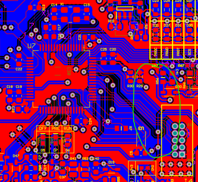

I am developing a custom PCB and am having a problem while trying to flash the chip.
Before delving further, I need to say that I have made a mistake with routing the JTAG traces to 10pin JTAG connector and may have burnt the chip. I tried to circumvent this by soldering a new chip and using external wires as made a new connector for JTAG 20 to 10pin adapter (https://www.adafruit.com/product/2094) which then connects to ST-LINK/V2:
After this I would get TDI ERROR message. I tried every possible type of connection available on STM32 ST-LINK Utility and STM32CubeProgrammer. I only maybe haven't tried to lower down the frequency.
I checked the connections made to the chip and everything seemed fine. Every power pin gets correct voltage and there are no short circuits. The power comes through 2 LDOs: 1 is 3.3V and the other is 5V and the power input to the board is 12.5V and around 70mA. The boot pin 1 is connected to ground.
I do not know what to try next besides cutting traces on the board and resoldering them on the board but that does not seem like it would make much difference since rewiring the connector did not work.

maybe PCB layout is affecting the connection and the board should have 4 layers instead of 2:
- I think that the marked trace could be troubling as well since the bottom layer should be ground but said trace is "splitting the ground plane and maybe messing up return current path for the communication but maybe I am overreaching with this

Is VCAP voltage around 1.2 V?
70nKA
Yes that was correct.
It turns out that chip was probably faulty or I have maybe overheated it during soldering. Once a new STM was soldered the connection worked well.
